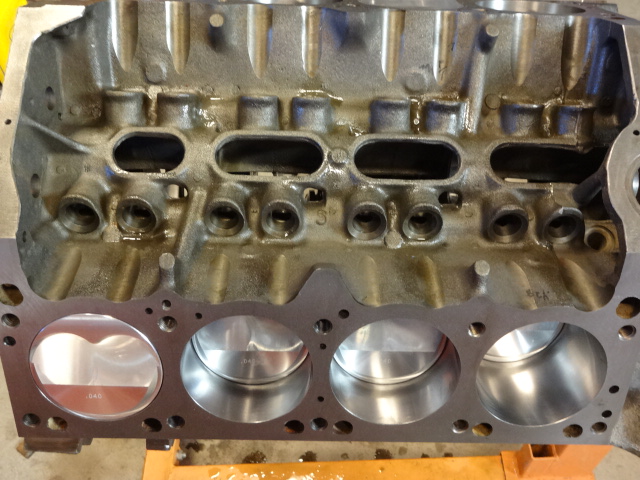

Im wondering about the bore notch might actually being helpful in the same way a indy 360-1 head gives up a few cc for the chamber design around the intake valve blending it into the chamber.

Id be tempted to try the tiny bore notch on a low comp 318 but id not be comfortable with a zero deck piston.
