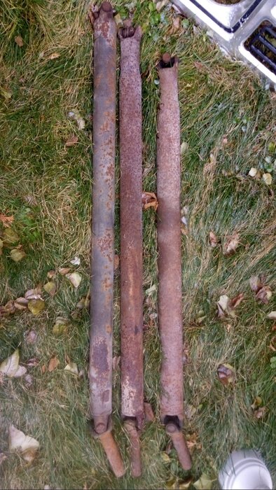

This is side by side comparison of the 3 different lengths of 4 door automatic drive shafts i have. From long to short,
7 1/4-904
8 1/4-904
8 1/4-727
