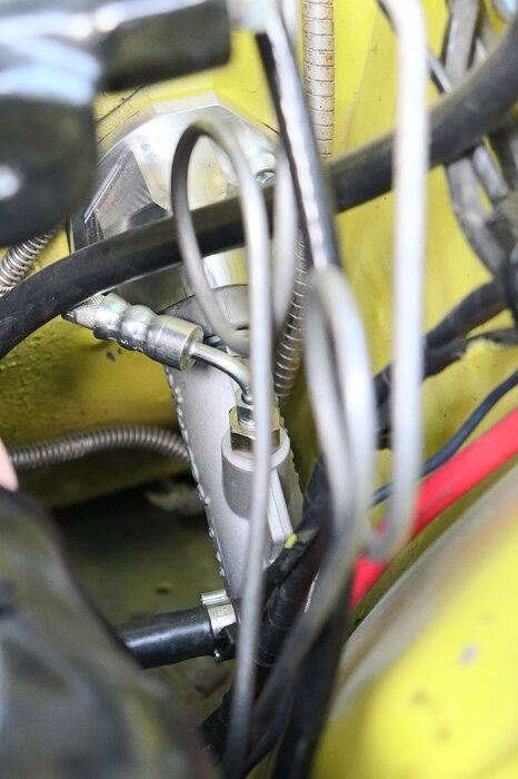

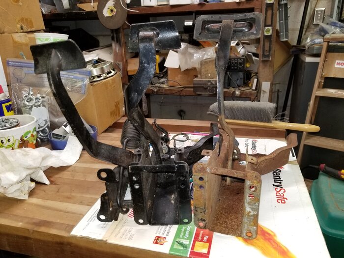

    Here is a petal set from a '79 F (black) and petal set from a '84 Gran Fury (rust colored).
    (Note: F/M body with cast iron brake master cylinder will have a slightly different bolt pattern – but that only matters if you are using manual brakes).
    The metal frame is the same on both petal sets, as well as the stop light switch..
    Everything else is different – and that includes the petals, the pivot shaft (is longer for the second petal) and the left side bracket. The firewall has two extra holes in it. The factory uses a reinforcement bracket (goes in from engine side of firewall), part # 2950680 ( Firewall Clutch Reinforcement Bracket Fits 71-74 B-Body and E-Body Mopar Cuda | eBay ) for that side bracket.

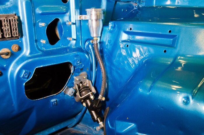

    This is a couple of pictures I collected that shows the master cylinder install (both from an A-body):
