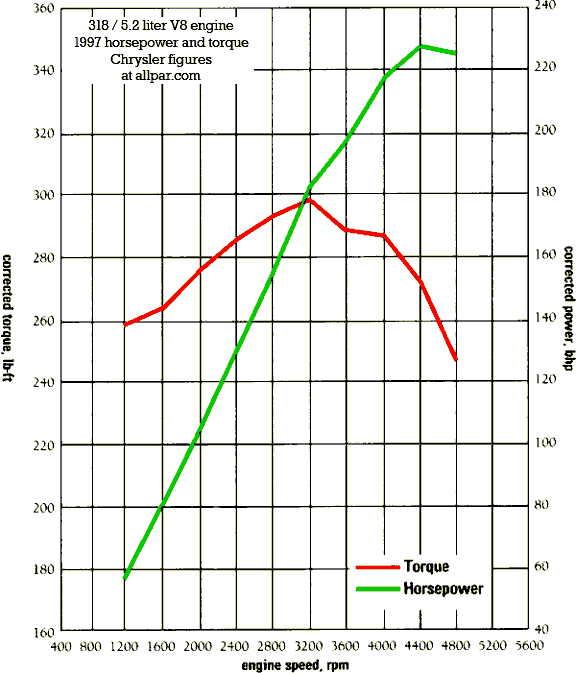

Following, is a MAGNUM 5.2 power curve for your perusal. Look at the power difference from 1800 to 2800, and you will see what I mean; I see ~90hp versus ~155.
The 4bbl cannot touch this power increase, limited at the factory stall.

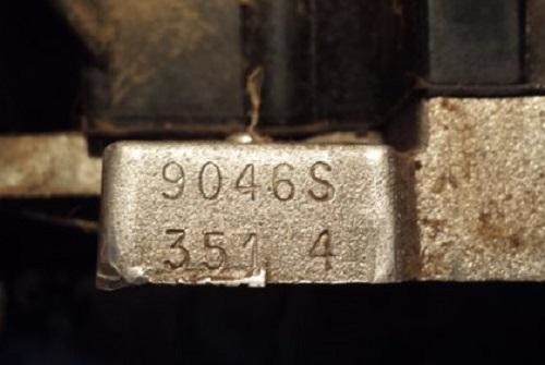

On the drivers side rear of the TQ baseplate there will be numbers stamped. The top number is the model number the lower number is date it was made.
Example:
This one is model 9046s. Made the 351st day of '74.

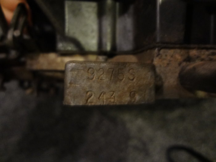

My thermoquad reads "9275S" on the top row, and "243 9" on the bottom row. Below is an image of the actual carb's numbers.
I'm not sure if this is original to the 1982 Dodge Travco motorhome that it was originally on, but I know that was the vehicle I got it off.

That's 78-79 360 truck.
Motorhomes and coach built stuff is strange. Sometimes parts can be from older years of they had bought in bulk from the vehicle manufacturer and had stock to use up but they usually leave the engine the way it came.

@Mikes5thAve is correct, this TQ came from a 78-79 360 pickup. It has the smaller primary's and also has an electric Bowl Vent - which will need something done with it or carburetor will not work correctly (send me a conversation for instructions about the Bowl Vent).
Bowl Vent aside, I rate this TQ as a yellow (Green is the early ones that work great, no matter what, and Red is the late ones - that I wouldn't use if someone paid me (aka, what was used on FMJ's)).
This particular unit was made on 249th day of '79. It is very possible this unit is correct for this vehicle for motor homes were done differently than cars/trucks were. I have a '79 360 motor home engine that came out of a '80 or '81 motorhome. The engine came from a different manufacturing plant as the cars/pickups came from.

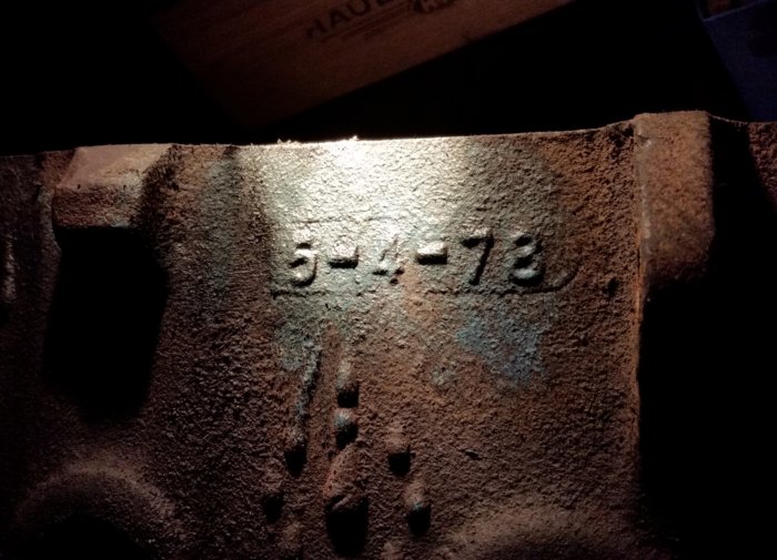

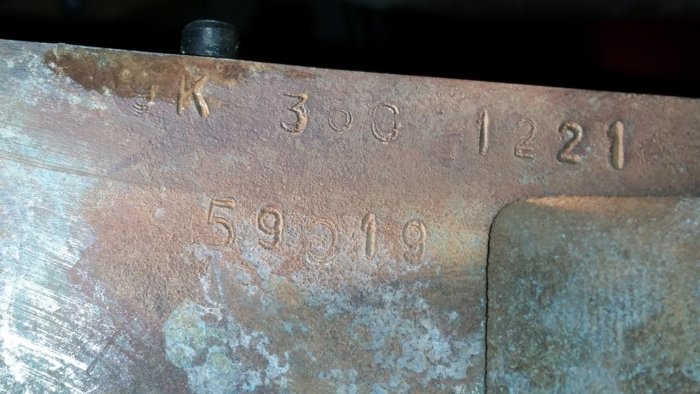

My '79 360 Motorhome engine is very odd:
Block was cast on May 4, '78
EIN number is "9K 360 1221 59019". Engine was assembled on December 21, 1979, at "K" engine plant (Kokomo ??). The last four (five, in this case) is 19th engine made that day and I suspect "59" might be the motorhome contractor. Most blocks are cast a week to a couple of months before assembly date - not 19.5 months later.
I also suspect your 360 might have similar details (maybe).
