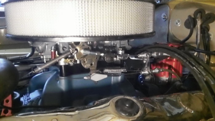

    Lokar throttle and kick-down on my 360/727/A body. Love em.
    I have a good used V8 F body throttle cable. $15 plus shipping.

  7. F body Deconstructor Jim
    F body Deconstructor Jim Well-Known Member
    544
    133
    Jun 19, 2011
    Phoenix, AZ
    I understood the bracket was different for the 4bbl, not the cable?
    Only noticed 3 lengths...slant, super six slant and V8.

    Thanks everyone for great information, i have eldelbrock rpm magnum intake . Car has /6 1 barrel so i will have to get cable . The lokar looks like a pretty good setup to work with . Deconstructors pic looks great .

    V8 cable...2 or 4...not sure...factory kickdown 650 braswell/holley, 90? roller lifter 360/904
