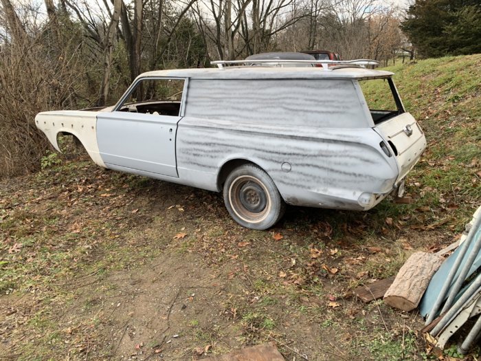

Thanks for replying. This is what I have going on : 65 Dart wagon that I was going to use the 65 833 and all associated 4 speed stuff. I already have mocked up a modified J Body underdash harness (forgot from what year) to work with my modified engine harness. The plan was to use a J Body steering column w/o shifter that I have (an 80 I believe) that my underdash harness will plug into the ignition parts on the column. My clutch leg has worsened to the point I can hardly lift it up to even clutch pedal height, so I’ve made the decision to go to an automatic, a rebuilt A500 to be exact, since that’s what I have on hand. It would be no problem to use the floor shift column I have and use an aftermarket automatic floor shifter. But since the wagon is heavily modified inside and out - custom dash, swap to factory AC including the firewall, complete 66 Barracuda interior, power door windows, power door locks and on the exterior, conversion to a 2 door sedan delivery, it would be great to have a column shifted tilt column, which the ignition parts would have to integrate with my underdash harness. I am not worried about the shift linkage from the column to the trans since it’s likely going to need to be fabricated anyway. That’s where I’m at right now.
EDIT: pic added

Cool looking Dart! There's a pair of those being neglected on the other side of the country block from me along with a few mid 50's Packards. Given that the relationship of the firewall to back of engine should remain very similar across models, you shouldn't have linkage issues. The column length would be my concern. The Mopar units are slightly modified GM Saginaw's and longer than a standard column which you could set at the desired angle. That's why they only came with the flat "blade" steering wheels until the 80's wheel redesign. You just can't put a standard dished wheel on them without rubbing your gut or, other protrusions while reaching the pedals. Some guys have found that if you use a Grant GM adaptor to mount a Tuff Wheel, it actually places the wheel back so far that you need to shim it out to get it off the turn stalk and shifter tho. If your harness is an '80, you may be a little screwed on parts availability in any case. My suggestion would be to use an 80's M tilt column and swap wires around as necessary to make the plugs work. Most likely you'd want to grab it from some junkyard car and cut the harness side of the plugs and splice the pigtails into your new column. I assume you have access to the occasional 5thA's and Dippy's coming thru local yards yet today? That would sure be cheaper than paying myself or another to hunt one down and grab your needs.

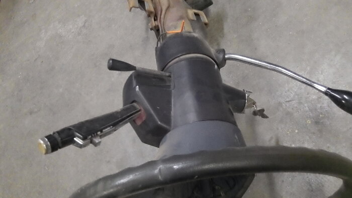

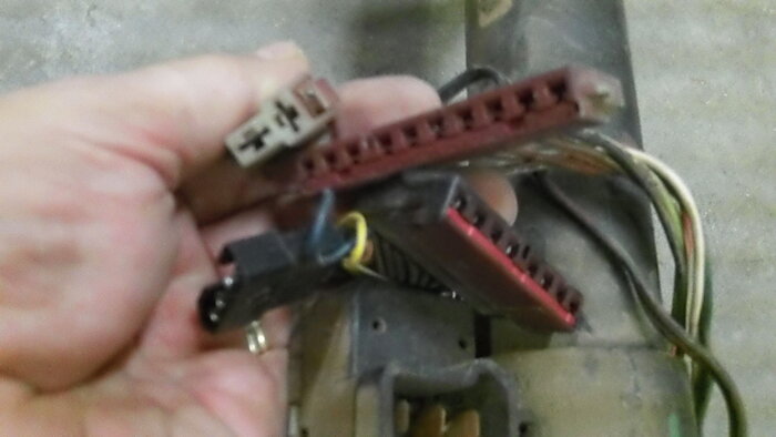

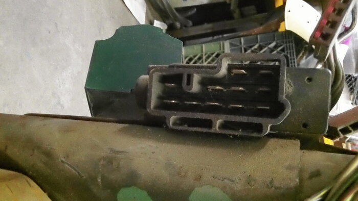

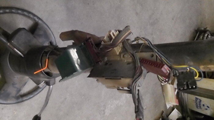

Hey you won't believe what I found while cleaning the garage yesterday. Do these connections look right? I remember when I got this in a load of parts F &M parts now, but never identified it to hang it upstairs. It's got wipers and cruise on the turn stalk, and this coffee brown color had to be an early 80's thing cuz I dont remember seeing it in the late 80's is all I know.

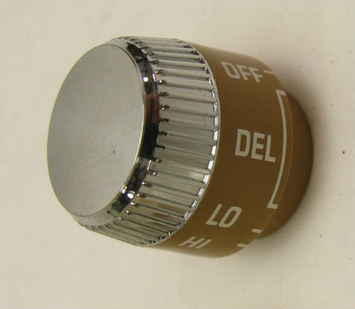

The key to look for - for Chrysler's, is the turn signal switch/cruise switch. It needs to have the visibly noticeable pull-off end (part chrome, part color) for it to work.

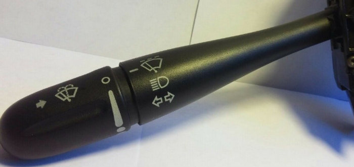

In about '90 (or so), Chrysler went to a completely different column design that has a different looking turn signal stalk. I would think anything with this design of turn signal – the column will not be of much help.
BTW, that is a nice looking project!

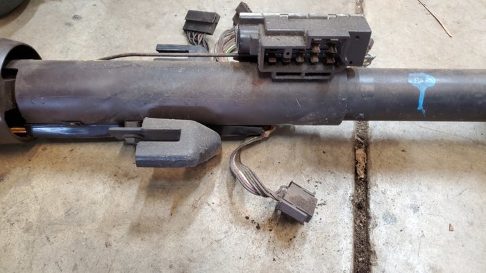

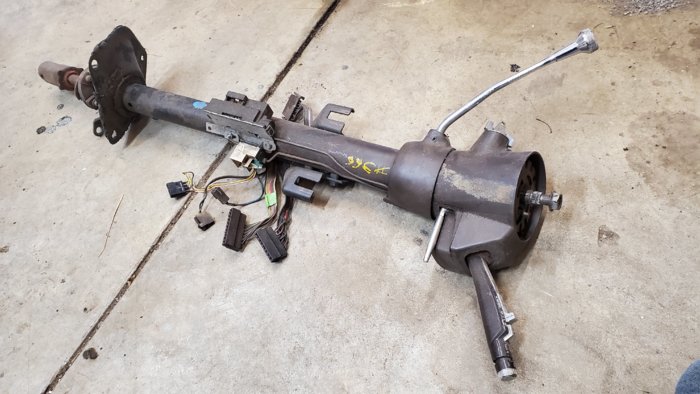

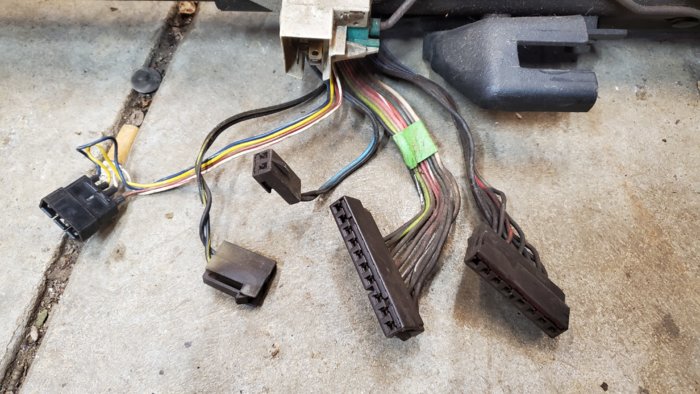

I think I have an 80 F tilt column shift in storage.
80 F has the wipers on the column. should be complete.
if that'll work I'll go check storage tomorrow am when its not 100*+:D

Thanks for the info on it - electrical connectors look different than what’s on my harness.
1,494
Chrysler changed the electrical connectors about every 2 years. Why - I don't know.
If column is correct (except for electrical) then I would carry over what electrical items you can or change the electrical connector(s) itself.
The F & M-body tilt column is the same from '80-89, with exceptions of floor shift (vs. column shift) and/or manual vs. P/steering - again except for the electrical connectors. the Switches themselves look the same, just they changed the connectors, for some odd reason, every couple of years or so.
