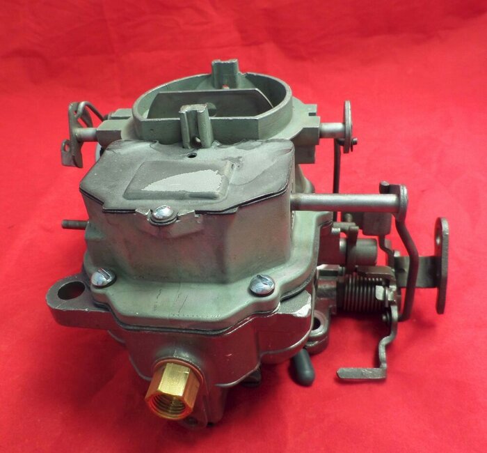

Carter BBD (Hightop version - which is used on all '76-84 FMJ's)

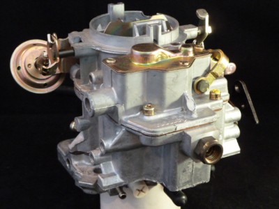

Holley 2280/6280 ('85-89 M-body).  The 2280 is shown.
