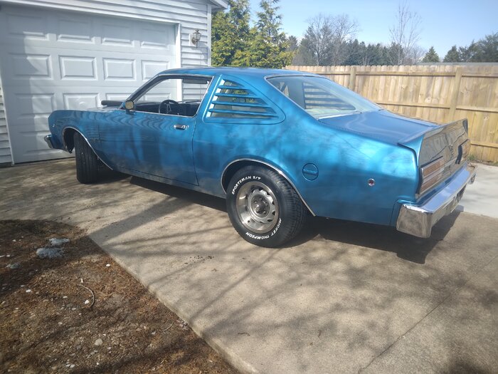

Lowbudget, that is a nice-looking set of wheels you have.
Did you the wheels painted that color?
The only 15” Chrysler road wheels I recall with that color scheme was that was used on the ’70 300-H’s and they had a touch of pinstriping added to the paint. They also used a different dome/cap – but that part is easily changeable.
They came off of a 79 or 80 Gran Fury. They match the Diplomat paint perfect. My buddy sold them to me for 100.00. I have a picture of them on the car on my phone that I will try and get loaded up. The Chebbie trim rings of Ebay are a tad to big. I just received a Chrysler Rally trim ring today from Wheel Vintiques today, that when my hernia repair I had done yesterday feels better I will try. My friend said I need to come grab everything else that I can use off of the car. The heater assembly is already in my beater 5th Avenue. You have to love friends like that.

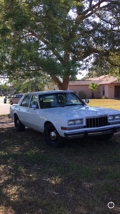

I don't know what the cop car he owns has on it for an air cleaner. I know it has front and rear sway bars but a non Sure Grip rear end. He does have an M body sure grip which I have already claimed along with the above mentioned sway bars.. I imagine they will go in the 5th Ave. beater as the Diplomat is a 60,000 mile survivor and I hate changing it. I didn't get over there Sunday, maybe next Sunday.

Most police cars did not come with limited slip. In most cases different company's (Ford, GM, etc.) submitted bids for X number of cars. The low bid got the contract – so some options, like limited slip got omitted.
Most B/R body police cars did get 9¼” differentials (12 bolt inspection cover). If it does have a 9¼” then there is no question it is an R body.

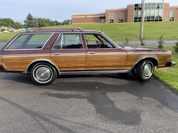

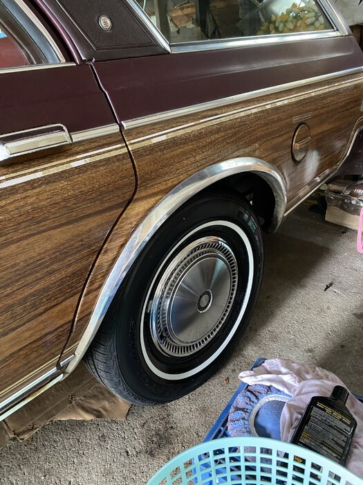

Great comments on tires and wheels. I have the stock steel wheels on my 81 diplomat wagon, does anyone know how wide these are? I was thinking of 215/75/15 all the way around but would go wider in the rear, just think the stock Steelies may only be 6 inches?
If the steelies are stock, they are 15 x 7.
Went with whitewalls and original hubcaps… I had two hubcaps, found two more a while back and ordered them up. Went 215/75/15 Nexen N prez… price was amazing…
Kramer79, LOVE your wagon! Good choice on wheel covers and tires!
