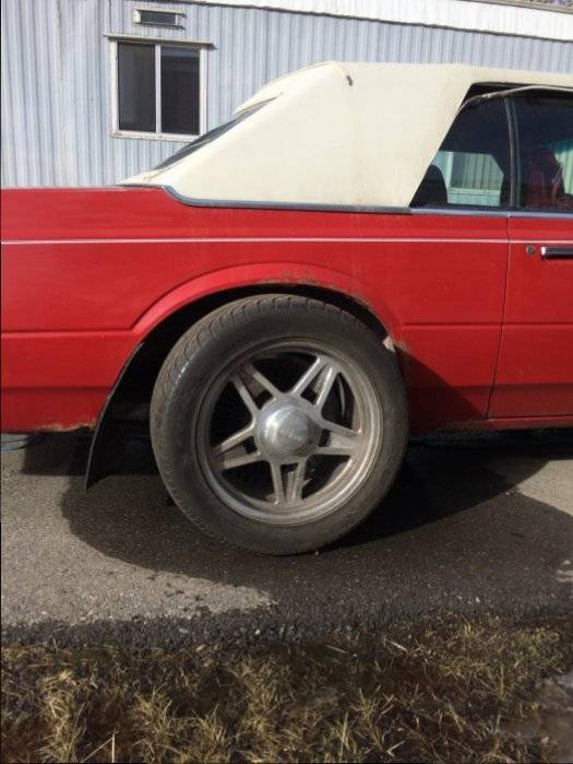

    I couldn't believe it, but i just fit a 275/40/17 on the front of Modoba with no clearances issues anywhere. wheels are 17x9 alcoa forged. Could fit 285s but rim not wide enough for that. Enough room on the rears to fit 295 and just maybe 305.

    from the mounting surface of the wheel to the back edge of the wheel is 5 5/8"

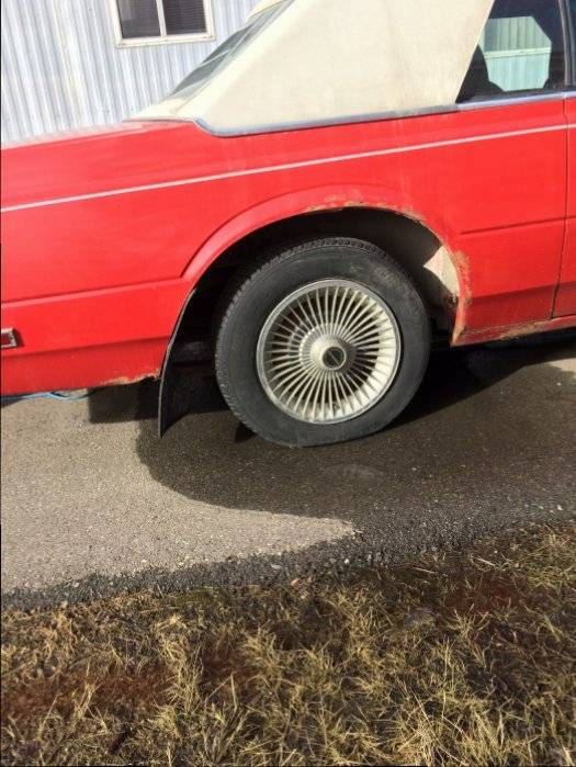

    Don't worry y'all, I still have my original 5 on 5's. Didn't realize just how big the wheel arches are... could have went 18" no problem. 170325_0001.jpg

    I did a mock up of an old set of Weld Racing forged billet wheels in 17" size, and they looked really good with 255/45-17 tires. and they really weren't much bigger than the factory sized 15" rim with 205/75-15 tires.
    This is the facotory wheels I have on there now:

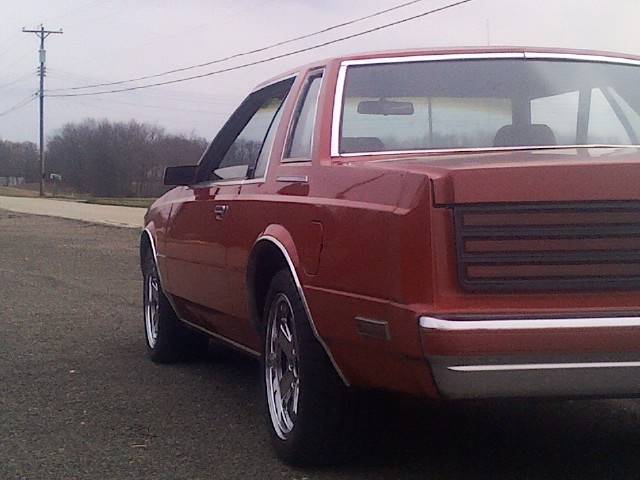

    This is the Weld wheel just put in front of the factory wheel just to see:
    The Weld whee looks much bigger due to the wheel being closer to the camera. In reality, there is less than 1" in height difference between the two, and that doesn't even take into consideration that the original wheels need a little bit more air pressure, and they are supporting the weight of the car.
