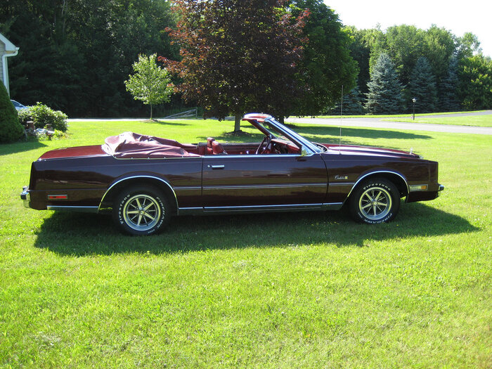

I really like the look of the factory original Goodyear polyglass radials. They came in the 215 70 15 size. Reproduction tires are only available in the 225 70 15 size which was used on Corvettes. The tires pictured on my car above are originals. I only put them on for pictures as I don't trust them for regular use at their age.
