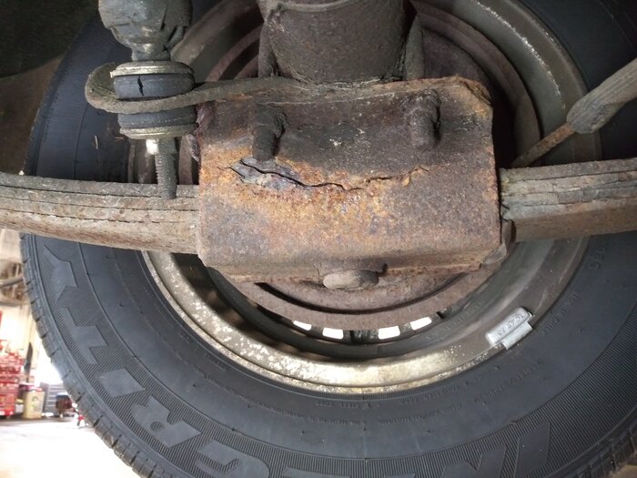

to iso clamp or not to iso clmp?
picklesgarage
Jul 7, 2019
132
26
center conway nh
so I know I have a problem with my iso clamps. cant seem to find replacements. seems like there is equal split as to people in favor of replace bushing and keep iso clamps and those who say to switch over to b body shock plates. I thought I read here that going to the b body style is going to drop the rear a bit which I don't really want right now. I know there is better selection with rear shocks not using the iso set up. except the rattle right now in the rear from I think the shocks I enjoy the ride. I should really replace the springs but that's not really in the budget at the moment. I do plan to swap to an 8.25 but again budget. so my question is bang for buck and ease and I better to go to the b body shock plates or does someone have some iso mounts or at least the proper diamentions so I can get some made up?
oh almost forgot, 86 5th ave. currently stock, planes to go 8.25 and 4bbl. looking at mostly street use maybe better handling at some point
thanks

The b-body shock plates will RAISE the rear of the car about half an inch. Not lower it. And give more stability to the rear since the rubber bits are gone.
7,323
2,971
Have you checked with Jim? I know, silly question. I assume you have a 7.25" so suppose those are tougher to come by.
If you keep the ISO, replacing the rubber with poly insulators helps a lot. Not ideal but still gives a little isolation. Replacement springs should have a round front spring eye, which will help a lot also. I've got poly insulators with the ISO set up (and round spring eyes) and haven't noticed any adverse effects. No wheel hop and the handling isn't bad, for a nose heavy BB F-body. I like them (JMO), others hate the ISO spring.
