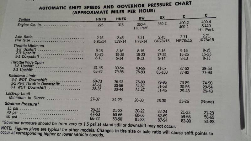

10,745
1,205

No seriously I can not feel the shifts. It is weird. It is obviously shifting are I would not be able to get to 50 mph but I feel no shifts at all.
10,745
1,205
Roll down the window and listen to the engine.
Go slow first.
You'll hear the rpm drops.
Try slow and then when you get a chance hammer it and check that out.
It's obviously shifting.....if it wasn't she'd be revving pretty high.

I guess I am use to a V-8 even though I have owned a few slant sixes in my life time. I just have never seen a vehicle that I could not feel shift. The other ones I could. Will follow that chart tomorrow and see if I can feel the shifts in between at slow and fast speeds.
