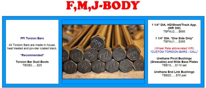

    I would “think” that if TTI make their own torsion bars, that they would also be making bushings/brackets for both ends, as well (I mean middle and outer end).
    This picture was taken of TTI’s website and it appears the middle bushing (pivot) – unless I have what they refer as pivot down incorrectly – is available.
    Would be nice if they had more pictures . . .
    It would be easy to spend $10,000 at their web site . . .
