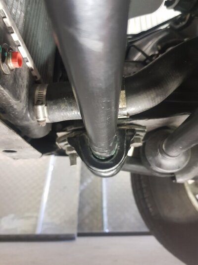

I was not happy with the polys on my torsion bars. The right hand side bushing started to squeak a little after a few months, and the pivot bushsing never looked right with a gap underneeth.

Nos T bar show bottom plate a bit concave, FF are flat. These poly in the last pic are 15 years old and still take and spit out red grease every year, zero noise and no gaps.

Not sure the pivot area is bent in the pic. It looks like the shim is causing it to not lay flat. BTW, I was never successful installing the NOS pivot rubber bushings. I tore them trying to get them in place.

I should of explained better in my posting sorry for any confusion.
The op-s pic to me shows the plate might be bent a little bit and I do not understand the spacer put in, the gap the spacer makes is equal to the gap at the bottom of the T bar and bushing.
The firm fell plates are flat and so are the oem ones we remove, do they all start a little concave. maybe due to the production process, I have one noce set of nos T bar assemblies I can check but last night I did find a old plate in my metal bucket and it is flat as well.

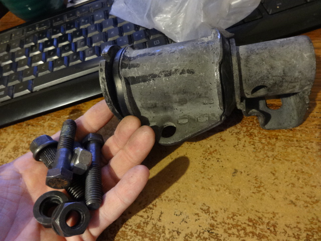

Forgot to post this... blown up a bit, I dont get the spacer and to me the plate looks a bit bent vs flat???
Who knows, I suck at everything but the two sets ive got seem to fit/sit well with no gaps or issues. Maybe just dumb luck.
So that spacer is actually an OEM plate that's serrated. It literally has a boat-load of hooks that "bite" into K-frame and I believe are meant to prevent any sort of motion (sliding) of the T-bar anchor assembly, see Mopar part# 4014073, "PLATE, Sspring Pivot Cushion Friction (Also in Bush. Pkg., 41061530).
When restoring my coupe I had actually installed these, sourcing them at a dealership was no problem some 20 yrs ago...LOL, my price was $1.89 ea, and not planning ahead far enough I ordered...TWO!!

I never quite understood the way the friction plates were installed at the factory. The used pivot plates I removed from other cars only appeared to have the friction plates mostly on the one end which seems to make it uneven and not lay flat. I would have thought it would have been all the way across from bolt hole to bolt hole but for some reason they didn`t do it that way. I wonder how important it is to even use the friction plates when using aftermarket bushings? Maybe not needed? My one car the poly bushings are worse than the ones the SUB03 shows in his pics. Things have keep me from redoing them at this time but i will get them apart and look at it again.

Ive never used the friction plates on the aftermarket FF parts and never had one move. You can see in the one pic of the old backing plate the friction plate does bite well.
I cant see a grease fitting in the op-s pic and I also wonder if all poly is created equal in density as for some it seems like the overall weight placed on the bushing compresses the top and helps create the lower gap.
We all know there are many oem things we omit on our cars without issue. With the bar greased it still would have side to side movement if there was movement to be had and the plates are not slotted front to rear so I see no use for the friction plates.
Here is a low mile untouched car. The plate cant really move front to back and the poly greased bar can move side to side on its own so I wonder if bolting the plate on flat to the K keeps things from bending?
I think you have som valid points XfbodyX. Thank you for pointing that out.

Like Volare 1977 said, the friction plate is made with a slotted U-shape to slide them in from the front, and they are roughly half the size of the bottom plate making the hole assembly look strange.
I even thought of cutting a 1/8" thick square piece of metal (in red in figure under) and install it between the bushing and bottom plate to compress the bushing a little.
