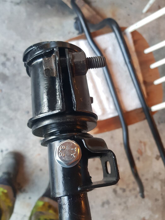

I installed the polybushings six months ago, and I was kind og disappionted with poor fitment.
The end bushings was a little short and going over bumps made them move a little and the right one made a clunking sound.
Eventually both sides made an annoying squeaking sound.
Then a funny thing happened; after searching for end bushings in the states for a long time before the rebuild with no luck, I typed in the part# on a website selling US car parts here in Norway. The Moog replacement came up. Got them installed on the Aspen and was very pleased with them.
I guess the parts store here had them on the shelf for years, not many F/M/J's left here anymore.

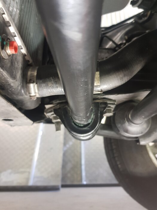

The pivot bushings doesn't fit too good either. It seems like the hole in them are too big for the T-bar:

I have the same thing going on. I was expecting them to open up/flatten a little bit, it always happens with Poly, but yea, it’s a bit rough looking. I don’t have any squeaking yet though, but I also used more bushing lube than what they supplied with the set. Idk, after a year of daily driving the car with the bushings in, I don’t have a real complaint about their overall functionality just yet.

I have the same problem with the poly on the pivot bushings getting deformed and loose. I ordered the firm feel ones this time but I haven`t installed them yet. I don`t know if they are any better though.

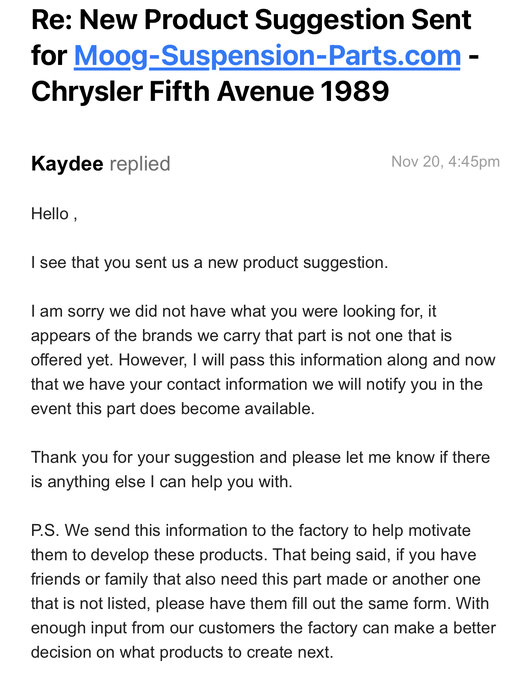

Moog actually responded about an inquiry I made. While the bar end bushing kits are unavailable currently, with enough requests, there is a chance we could get them made; eventually. They actually encouraged me to have as many people as possible request the part.
This link will take you to the inquiry form. If enough of us fill it out and ask for the bushing kits to be put back into production, it may actually happen.
Suggest a Part.
Can’t hurt to try since we have members on here from all around the world.

I thought about that (MOOG) last night. I spent a bunch of time searching every place I could think of to see if I could find end bushing and came up zip. I'll be sure to get back to their site and make a request. It's a part needed by many that's currently made from an unobtainium alloy.

I submitted my request. I identified that I got the link here. I also pointed out that the three bodies share alot of soft components which are drying, hardening, cracking, and just plain wearing out after all these years.

I did the same and also mentioned the mounts fit '76-'89 F/M/J body (actually I elaborated more specific than that but you get the idea).
