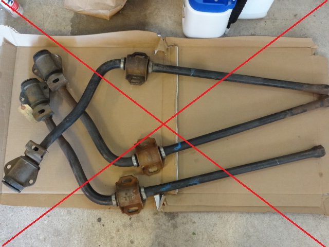

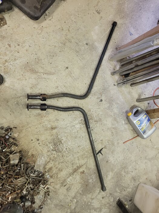

I'd try to find a donor. You're getting into different diameter there.
Left and right are different.
1,669
The bars are sided. What you have is correct. Also, all FMJ cars came with the same bars. There was only ever one spring rate produced unlike earlier Mopars that used straight bars.

Everyone differs on this. Obviously these are different sizes . One is newer. From a different car.
Newer bars were bigger and had more tensile strength. California had bigger bars made by Chrysler for the cop cars. Which also were used in NYC.
So there are differences from yr and model. So i am going to find a matching set from a junk yard near me. From a newer v8 model.

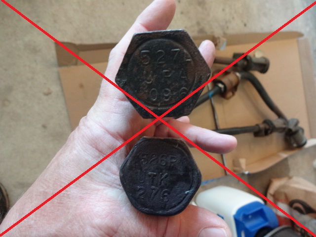

What are you measuring to determine size difference?
Post a pick of the ends of your current bars..the Hex end...you will find a three digit number on the top and two lines of info below.
1,669
It stands to reason thickness would differ between passenger and driver side. The spring rate decreases if you lengthen the bar without changing the diameter.
In all my time wrenching on these cars nobody has ever produced something to say otherwise. Part numbers never changed either. Not saying I'm gospel here though. Been proven wrong before.

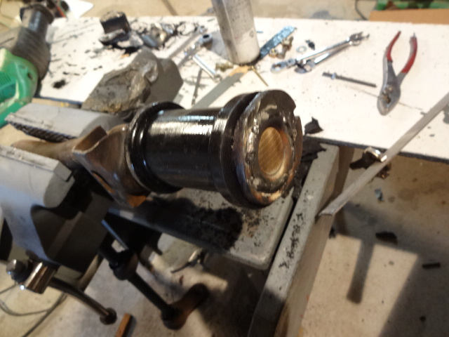

Vol77... keeping them whole and welding the end back on in the same indexed spot was simple, just made a tiny shield as not to get weld spatter on the poly. But just did one weld at a time and let it cool. Zero issues.

Vol77... keeping them whole and welding the end back on in the same indexed spot was simple, just made a tiny shield as not to get weld spatter on the poly. But just did one weld at a time and let it cool. Zero issues. Ok Good to hear. Seems easier too.

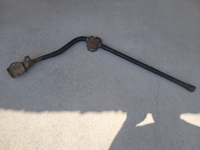

I looked it over some days ago when I first saw it listed. It has some cracking in the rubber so I passed on it. He had it at $499 plus shipping in the first listing.
