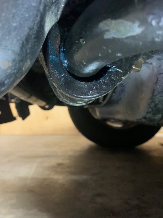

On My install, the end bushing #1102 was not on the fun category for the install.
The #1100 pivot bushing was easier, but I had some issues.
There is a small gap at the bottom of the bushing.
I talked to Johnny at Polybushings, he suggested to add a 1/8' plate above the bushing. I did but it did not help much.
He replied that he had not seen this issue and had no recommendations.
I wonder if just leaving it alone with the gap will affect my alignment or anything?

You’re not going to notice any difference or have issue with alignment. I don’t even want to think about how hard you’d have to load the suspension to get the bar to lift/lower off the frame and bushings. You’d bend the chassis and control arms trying to find out.
If he’s saying it’s the first he’s never heard of it, either no one else has complained or he’s lying. Happens to every set of poly pivot bushings I have ever seen installed.
Visual inspection, if required in your state for registration, could be an issue; to be fair though, some state inspection techs will flag an older Chrysler just over the play at 12O’Clock in the factory steering gearbox on a mint car.

I still think (but really don`t know) it has some type of hardness issue ( bushing too soft and can`t hold that amount of pressure) But that`s just my opinion

My car has the same issue. I'm using Firm Feel torsion bars and pivot bushings. They also recommended a thicker bottom plate I tried it didn't do anything. If I had to guess poly bushing is just deforming. I've thought about going back to rubber if I could find a set.
Tried NOS bushings and one tore just trying to get it on. I gave up on them. I assume it either takes a special tool /method or the bushings were dry rot.
