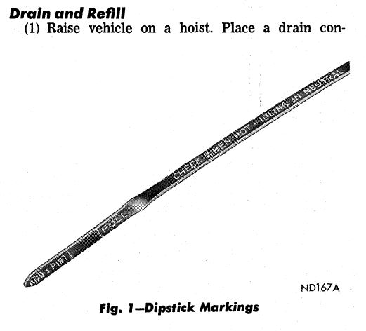

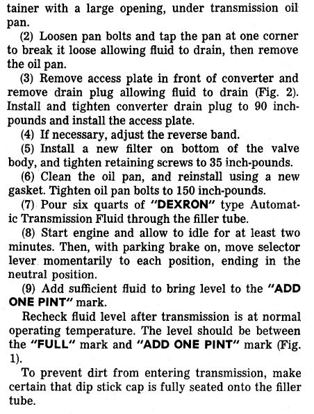

    I recommend filling transmission to proper level. As long as you don’t have a massive fluid leak, then drive car around for a while and see if any of the non-oil leak symptoms are still present – and report back.
    If you have a massive fluid leak – then stop.
    From my '77 FSM (Factory Service Manual). My '86 FSM says the same - except on what fluid to use.
    Note: the drain part is not needed, in this case - just the refill to correct level part.

    Torqueflite's are checked for fluid level in neutral. In park it will appear to be over full.

    Exactly (which is why I posted the directions on post #2).
    A common problem I see, of people not familiar with Chrysler transmissions – is the automatic fluid levels are not checked correctly (and I’m by no way implying the OP (Original Poster) is/has checking it incorrectly).
    I'm glad that Chrysler finally changed the fluid check method in the mid ‘90’s to a more common method – but that doesn’t apply to our cars.
    If you check fluid in Park and without cycling the shifter between the gear selections, first – a person will have an erroneous fluid reading (under full – by well over a couple of quarts, sometimes).
