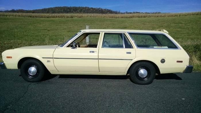

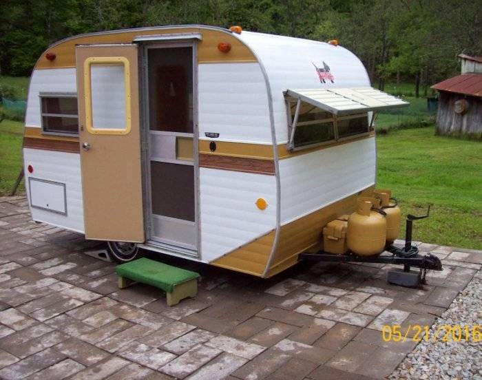

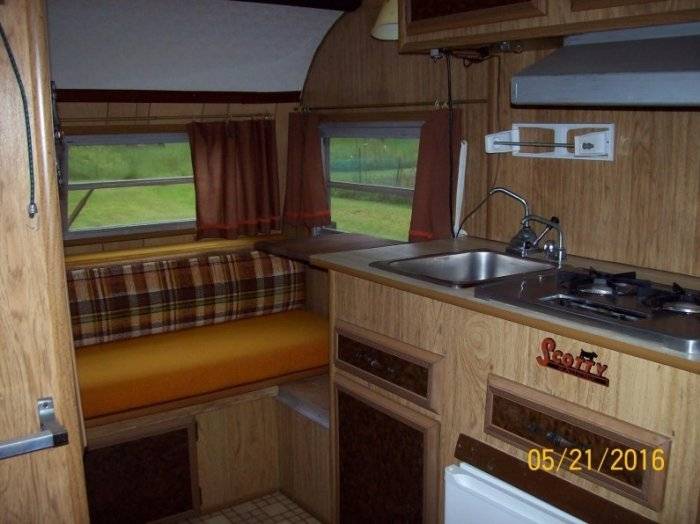

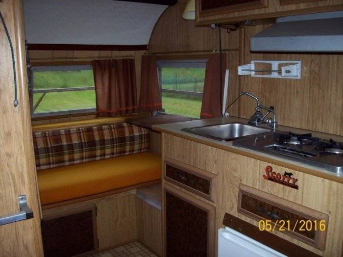

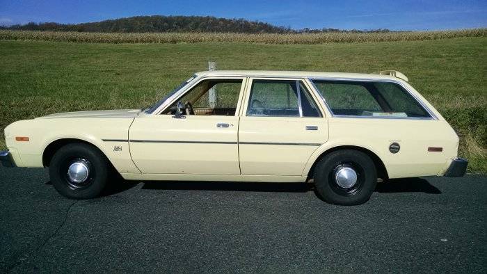

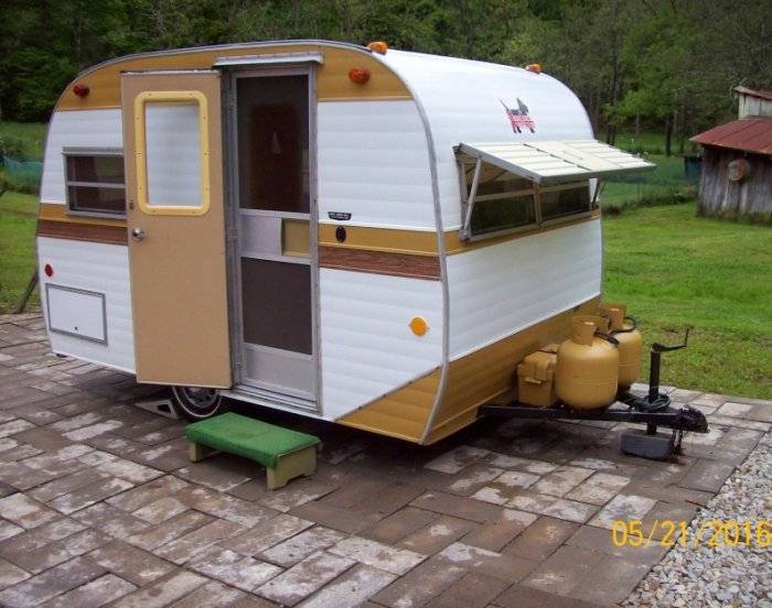

I really like the idea. I have thought the same thing, except I really like the vintage Scotty trailers. Here is a 1978 Scotty that would look great behind OY which is also a 1978. It even has a matching plaid interior! It probably wouldn't be a lot of fun to tow it with the four speed though.

Last fall the big RV dealership a block from my house had a 1950's(?) trailer on the lot. Coolest looking thing. Not sure how big it was, maybe 14 feet or so. It was pale yellow and ivory with pale yellow wheels and wide whites. Wish I'd have gone over and took a picture of it. The styling was so much better than the modern trailers.
