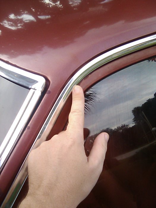

The chrome trim that's right above the doors, will that trim from an '87 Fifth Avenue fit an '85 Gran Fury?

Drip rail moulding/trim
I believe its all the same "profile" or cross section so its just a matter of lengths.
If the windshields interchange then I'd assume the A pillar leg is the same.
The horizontal sections length and how it terminates will tell the rest.

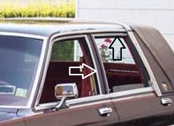

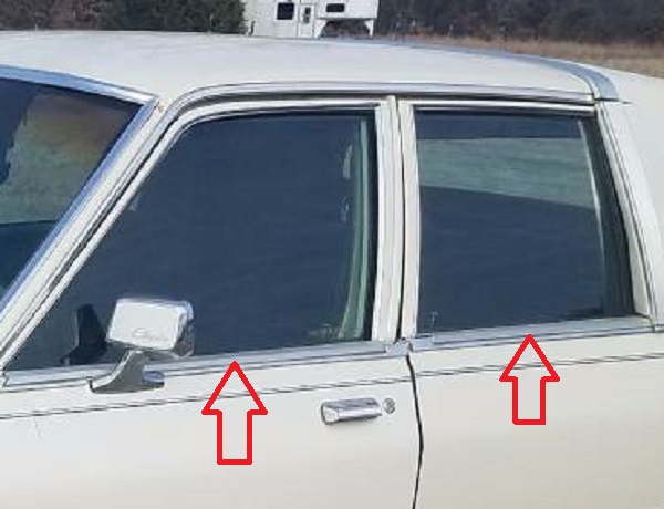

A friend of mine added these moldings (red arrows) and other trim from a Fifth Ave onto his F-body. It looked nice but a lot more work than what I would want to do (he liked the chrome appearance . . . I guess).
A lot of M-bodies come with a thin chrome piece that goes around the inside door glass frame - that looks like would also fit more-door F’s (but not wagons?) (black and white arrows).
The same trim is on the above yellow/cream car - but not as easy to see.
I’ve seen a couple of F wagons dressed up with M dashes and seats. I would think if I would do that, adding the rest of the fancy M door trim would be part of that conversion (maybe).

I would probably keep the F dash, only because the cars are becoming scarce and orginality blah blah, but the F Body cluster was pretty pathetic, right up there with the Chevette
As to the drip trim on the 4 doors, I'm pretty sure that the ones on most of the M's came down the sail panel at more of a squared off angle than the Volare. I think it's not as straight when it comes down at the back on the Volare 4 door. The doors are the same, the windshield is the same but the sail panel and back glass is a lot less curved
