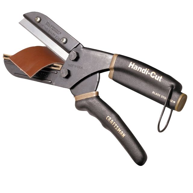

I'd use something like this:
Have those cutters but would never give me a straight line. Thought about the router too but at 30 + years some parts are hard and other are softer. I'd be afraid of tear out.

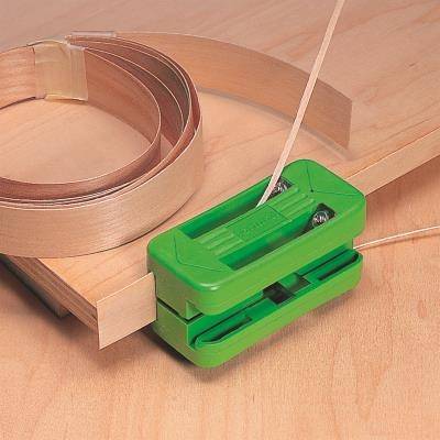

I've got busted silver, fake chrome on the edge of mine so I can cover up the blemishes. I haven't tried the laminate tool, but if you do, let us know how it works out.

Did the edge banding trimmer. Works if you are trying to remove the first 1/64 of the trim. As it gets thicker you push harder and it tares and the cut gets sloppy. If it were in a place,say vertical, you might get away with it. But against a chrome bumper, everything shows. I think one of the problems is the inconsistency with the density of the material. Too much heat and sun and its brittle, then soft spot and it distorts when pushing through a cut.
