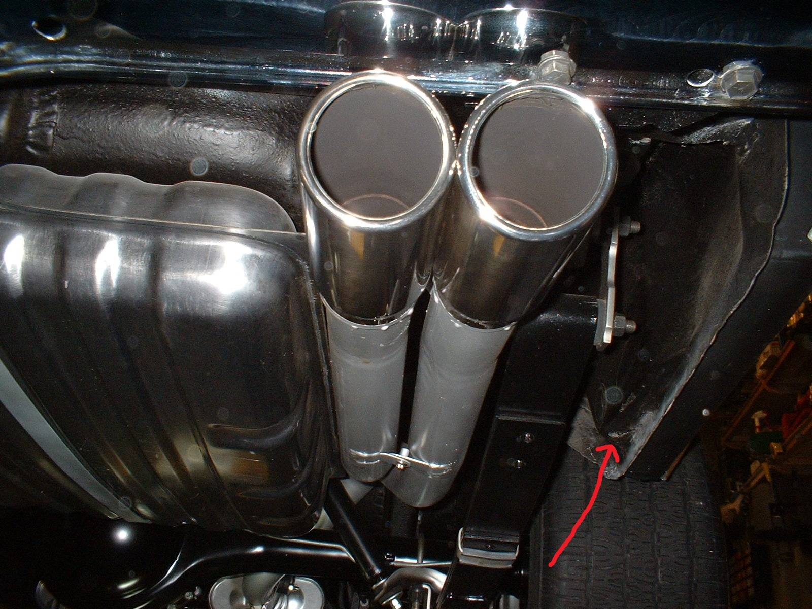

There should be small weep holes in the lower part of the trunk extensions, just behind the wheel wells. I assume an M-body would have the same, or similar, to an F-body anyways. Look like a small louver more than a hole.

It's (undercarriage) the result of a 10 year long build. It has been on the open road, but not a whole lot yet. Only about 450 miles since the first drive in 2012. Also helped that the last winter (I'm in Saltconsin, I mean Wisconsin, lol) it saw was in 1987 when I bought it, then it sat from 1996-2012 while I built it ('96-'02 it just sat in the garage with a fried trans while life got in the way).
