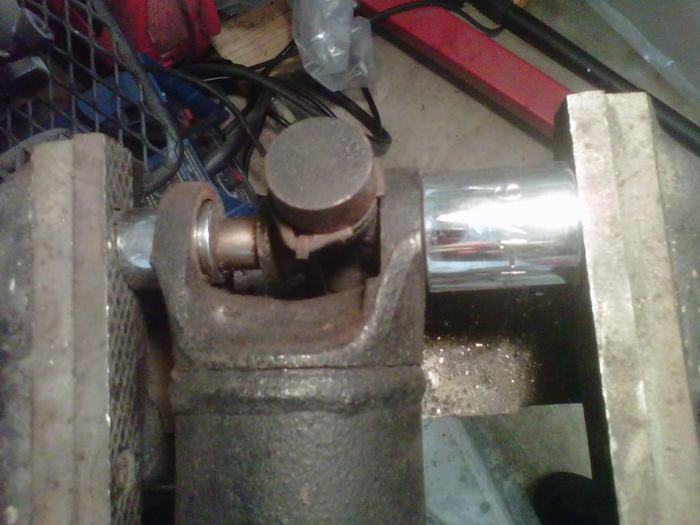

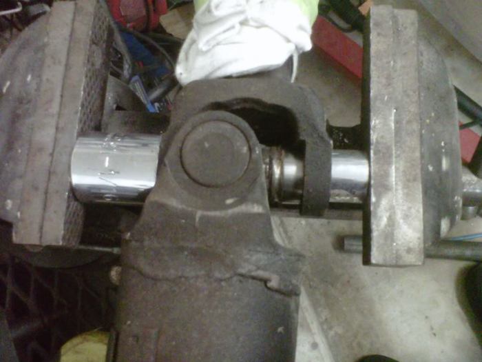

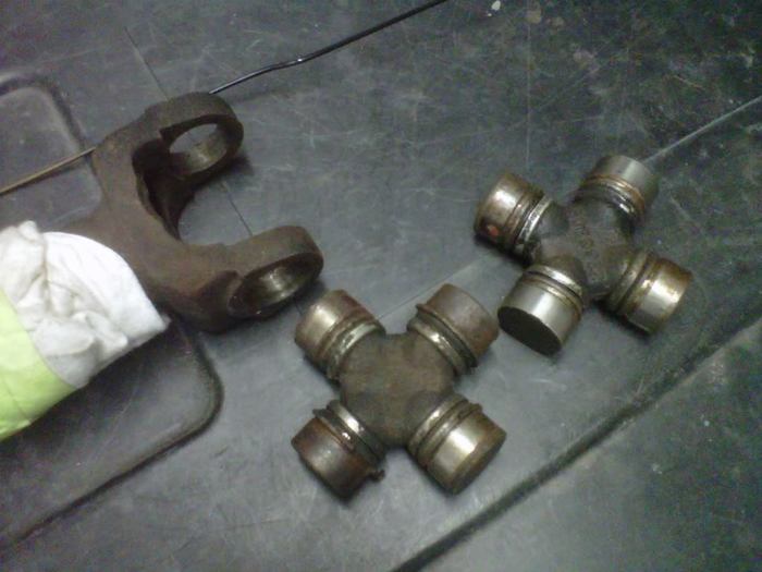

I did the removal this way last night...another at home option...bench vise and two different sockets...

Just make sure you use old, cheap made in China sockets...... that you don't like very much. lol

Or just hit 'em on the cross with a hammer with the driveshaft laying on a piece of soft 2X4. Saves your sockets and get's 'em out with one or two good wacks.
