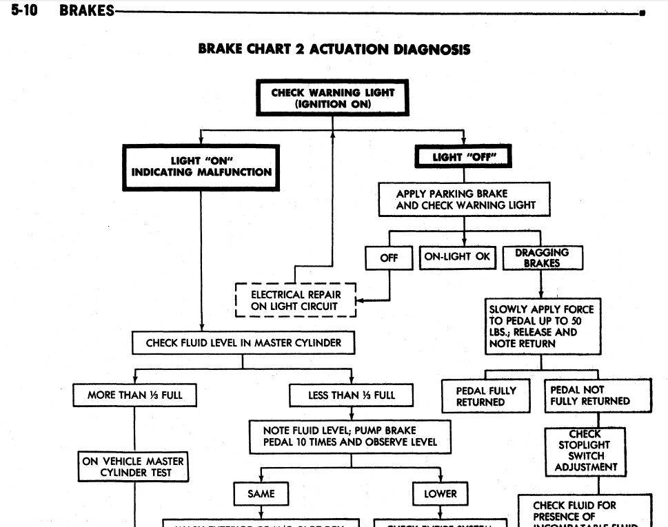

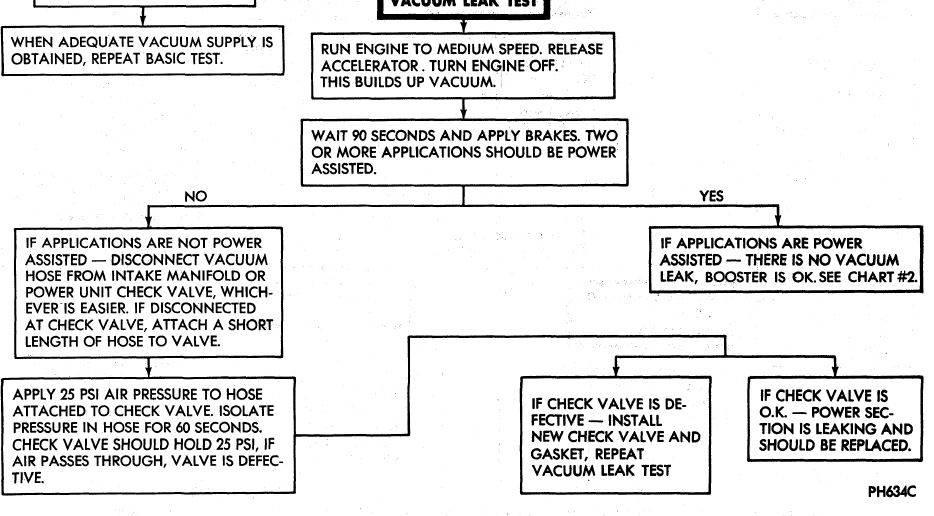

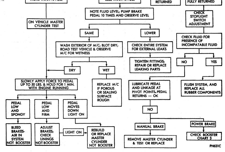

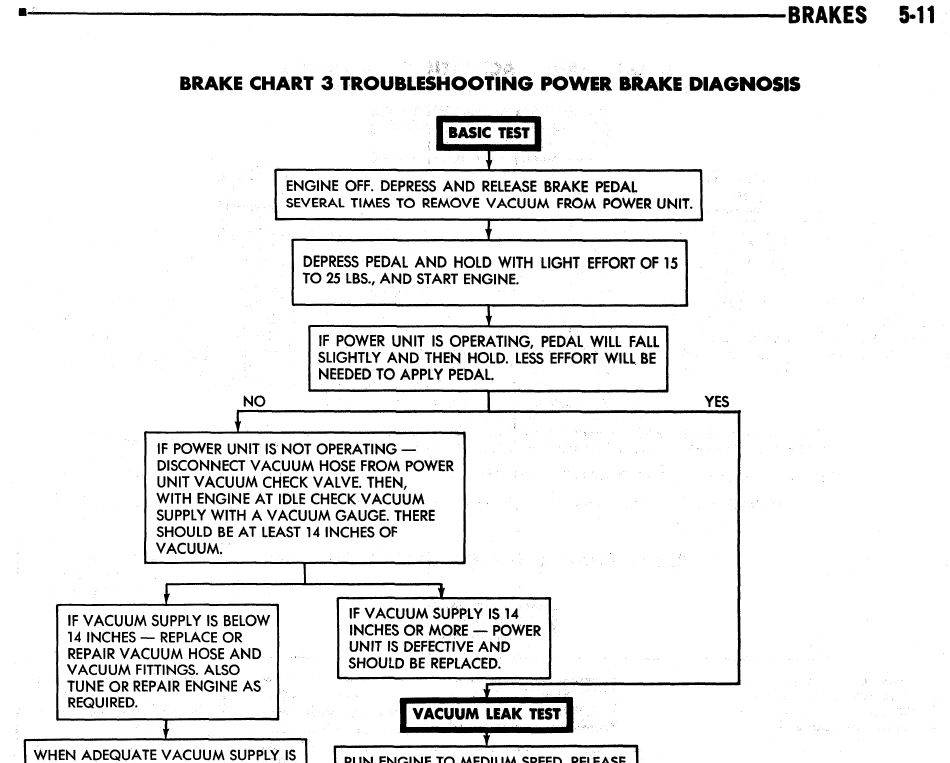

Brake booster is a repair you can perform, if you don’t mind laying on your back in front of the L/F seat, using normal hand tools. Not a comfortable job – but is doable.
If paying a repair shop, they “should” want 1.1 hours to do it.
I would guess 2½ hours for you.
It is faster if you don’t mess with the brake master cylinder, and just unbolt it front the brake booster, first (two nuts, with a bracket for cruise control cable).
The question is if you need a brake master cylinder, or not.
Tests from my ’77 FSM (should apply in your case).
I would check the flow charts, and if nothing indicates a problem with brake master cylinder, then I would avoid it.
The best test I know is when engine is running, hold down the brake petal. It shouldn’t slowly go to the floor. If it does, they this would be a great time to change while there.
