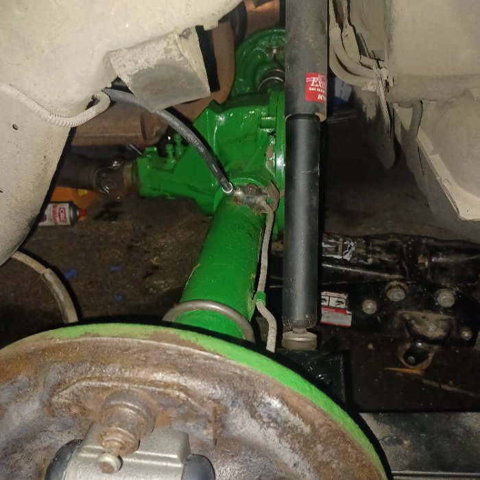

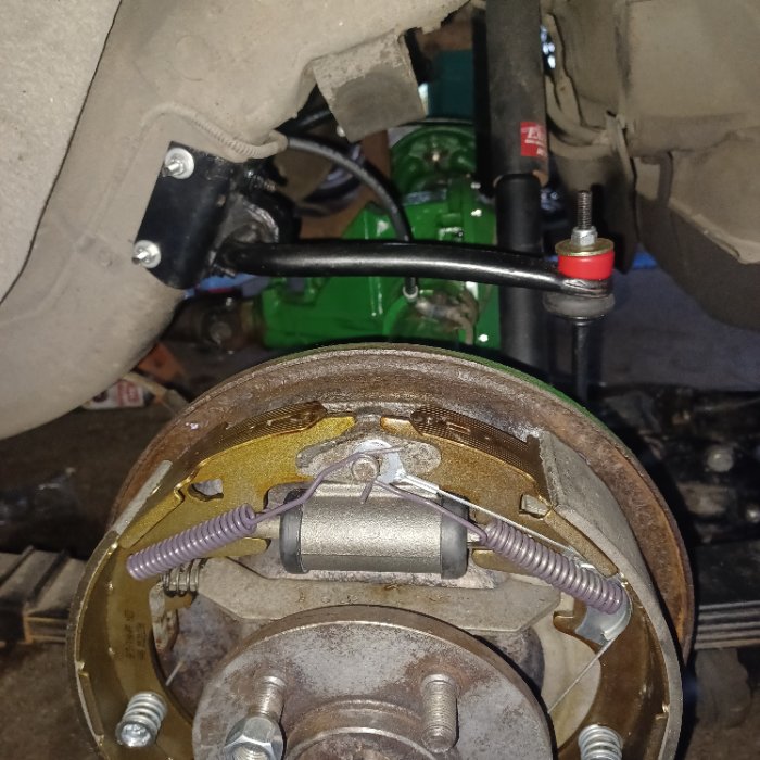

Don't forget you'll need a shorter drive shaft. I got mine out of a Volare. Axle is out of an old Diplomat police car. (and yeah i lost a sway bar bushing while i was installing that and slapped in a cheap rubber one, im a complete hack, i had left over green paint and painted the axle too) 20250808_202200.jpg20250810_184400.jpg
