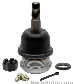

If you're upper ball joints are not loose they're OK. To change them you need the special socket and Popeye arms. They "thread" into the control arm. It's not a thread like on a bolt but more of a shallow V-shaped thread. When putting the new ones in it requires a MINIMUM of 125 ft lbs of torque before they are seated. If they screw in with less torque than that, the control arm has to be replaced or the joint could pop out. Don't ask me how I know this, lol.
A possibillity of why the right and left side look different is one of them was replaced at some point and just looks a bit different. I've seen front end parts from the same manufacturer where you get a pair of ball joints or tie rod ends and they look different. All depends on when they were made and maybe one of them was a slight redesign.

A pic of the threads:
