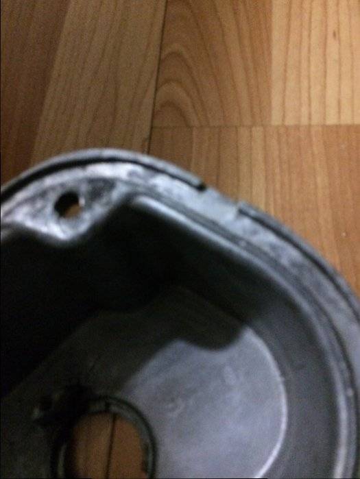

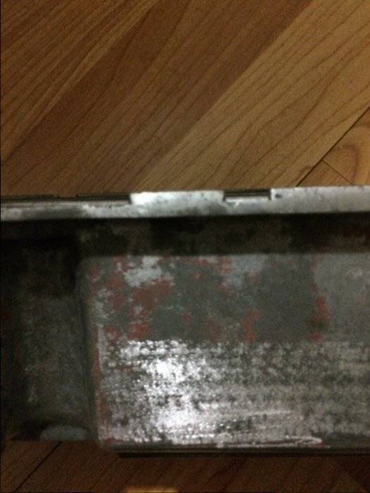

I have two pairs of the old MT cast aluminum valve covers. These valve covers have "notches" in the outer gasket rail (see pictures below). At some time in the past, I know gaskets were made with "tabs" that git into these "notches". Does anybody know if the are still being made, and if not, are they necessary anyway, in regards to preventing oil seepage?

The tabbed gaskets are going away. They generally start leaking at the tabs if you don't cut them off after installation. Newer gaskets are better made and tend to be easier to install

I don't know if it makea a difference, but they are small block M/T valve covers.
Consensus seems to be that the tabs on the gaskets don't make a difference. These are cast aluminum, so they wouldn't be warping much. I have read that the lhold downs for each valve cover bolt are a good idea, so I will be getting them before the valve covers go on.
