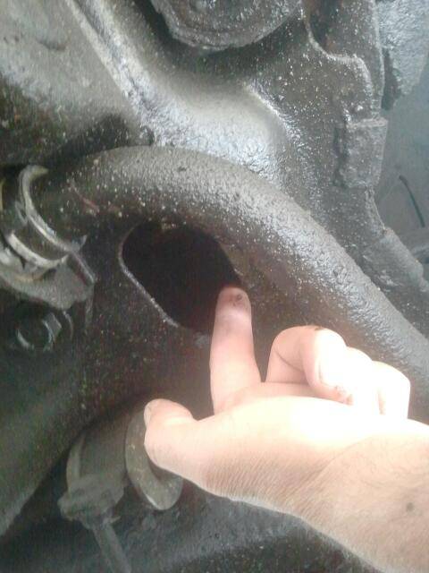

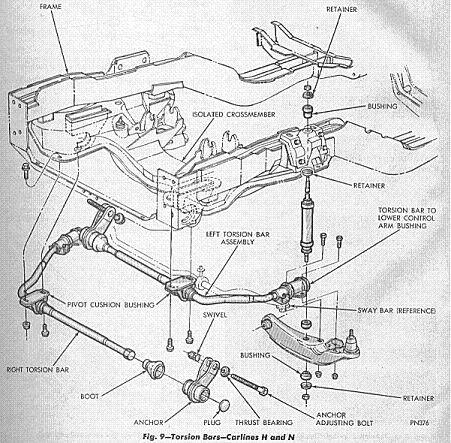

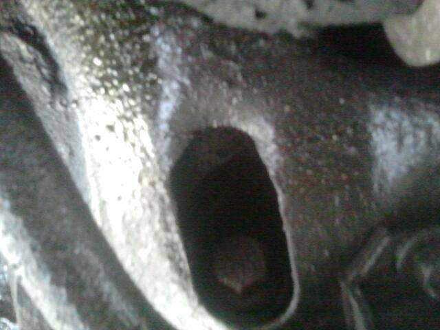

I think a good, easy place to start is to check the curve of the rear leaft springs. compare them side to side, and see if the arch is the same on both sides. If a rear leaf's arch has changed, it may make the front of the car on the opposite side rise upm or it may make the same side of the car ride low.
Kostas
Yes...they can be adjusted side to side.
http://www.dippy.org/forum2/index.php?topic=396.msg4493#msg4493
how new are your bushings? If they are questionable, change them. I mean if you start moving ride height around up front, some of that rubber gets to ripping real easy. Also, take the weight off the front suspension when adjusting. Put the car back down and step back, rinse repeat.....
