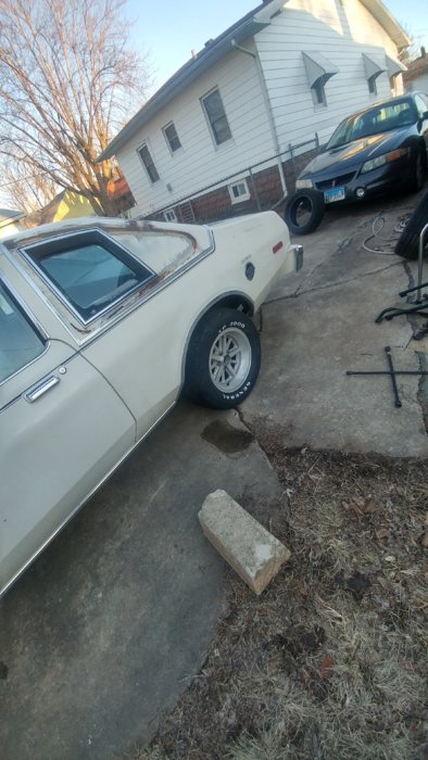

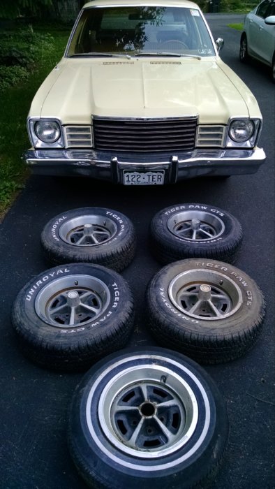

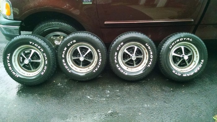

Test fit unwashed and with ancient tires.

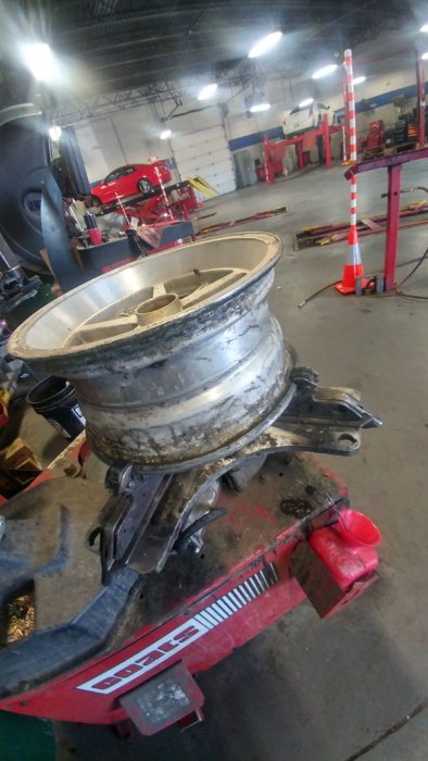

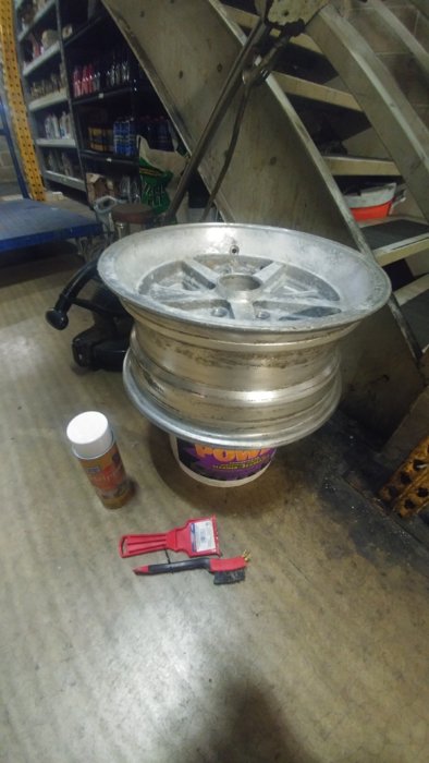

Inside was disgusting. Pressure washer and a wire wheel cleaned it up well.
Stripping the foggy and yellowed clear coat between cars at work. Lol

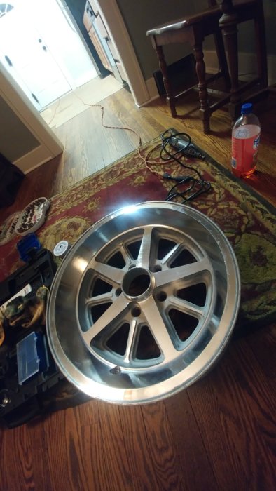

Cleans up pretty good! This is pre-polish.
Used some Mothers aluminum polish on some polishing wheels. Using my Dremel sped things up a bit.

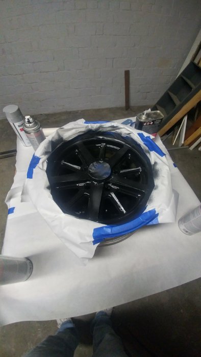

Taping all of it off was a bitch. Halfway through I remembered a trick I used on my badges and used crayon on the small inside spokes. Paint doesnt stick to it. Much easier than taping off.

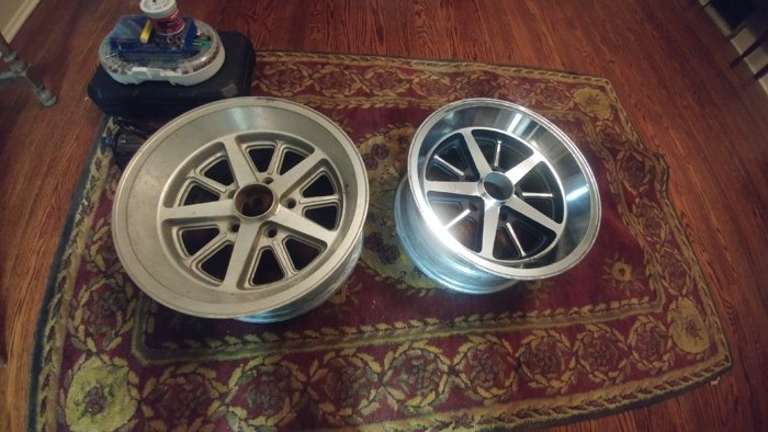

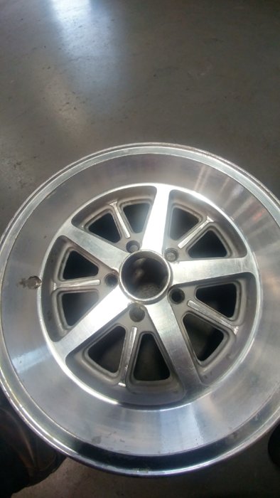

And the "finished" product. Could use a little more attention in a couple places, but significantly better than before. A little before and after action.
