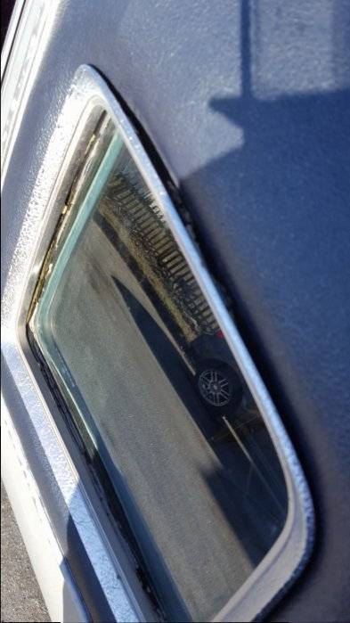

If it has the smaller opera window, those are mounted in a fibreglass plug. It will leak water into the car around the plug if you remove the vinyl.

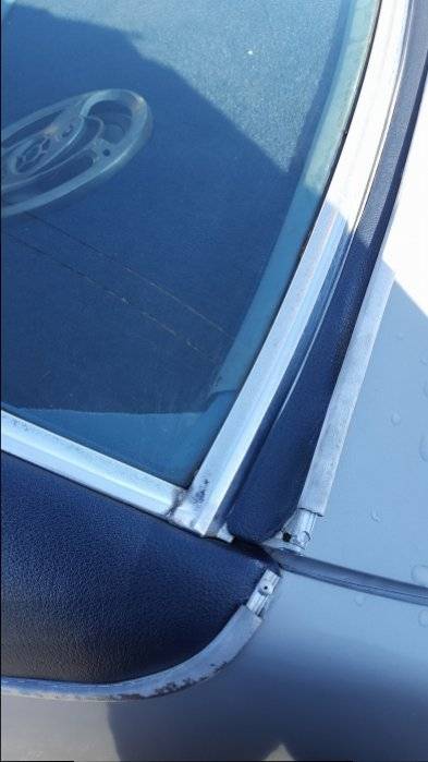

These are the problem areas in question. I guess it would be worth it to fix the top? I assume these pieces to hold the trim down arent super elusive. Definitely working to avoid a rust bucket as this is my first purchase!

Well, rust is always an issue. As Mr. C. stated above, the "opera windows" are installed in a fiberglass plug, that in turn, is installed in the body panel. To do away with the vinyl roof means that at least the seam of the plug will have to be dealt with. I've seen it done where the seam is filled in, but in my opinion, it never looks quite right. I'd probably try to seal the leaks myself, or if possible maybe even have the top replaced by a body shop after the seams are resealed. Probably pricey, but a good way to go depending on the overall condition of the car and your plans for it.
