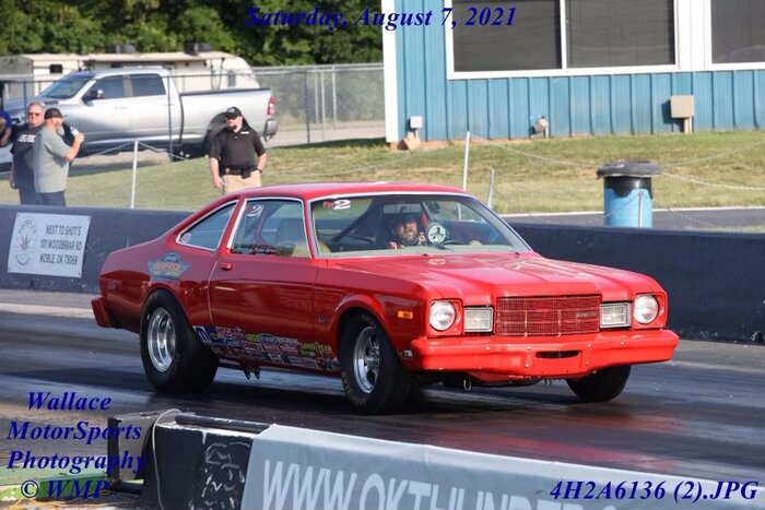

Since the car decided to make a right hand turn, after some severe braking, a couple of weeks ago at a Divisional race.
Found the car had 1" of toe in. & the K-frame upper control arm mounts are bent inward.
Seasons of a 3700lb + car wheel stands has beat it to death.
Read some really good threads here about the front ends on these cars on this site.
Unable to really do anything with the camber right now, but just getting the toe in corrected helped alot.
Tested it Saturday, seems to drive & stop straight now.
Will be working on it over the off season.

Plan to replace the K-member, my brother brought me a Diplomat to pull one out of.
If it looks ok, I'm going to send it to a chassis guy I use & have him re-enforce it.

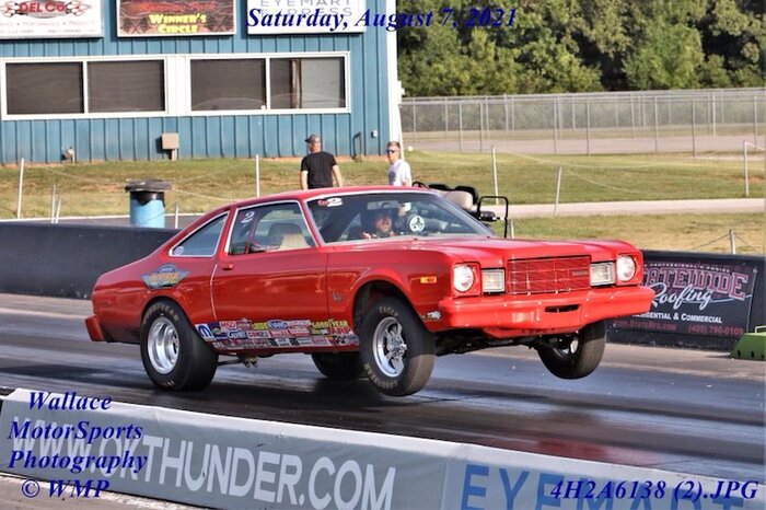

These cars are hard on this stuff, the lower bump stops didn't have any material left when we got the car.
It was using the shocks as bump stops LOL. Shocks were beat up & leaking.
Not many suppliers make race shocks for these. I wanted dual adjustables for it.
Checked with Viking shocks, they told me that due to the ride height(too low), they would sell me some (600.00), but wouldn't warranty them.
So, bought a new pair from Cal Trac, was told that I got the last pair, they were not going to offer them anymore.
I installed a taller lower poly bump stop, new shocks & raised the front end about an inch.
Seemed to help, it would bounce & unsettle the steering after coming down.
Didn't seem to have that problem testing.
