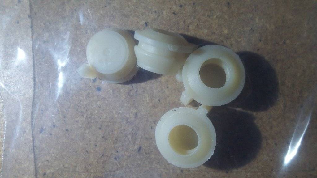

I have the correct linkage bushings in stock. 4/$6.80 plus shipping

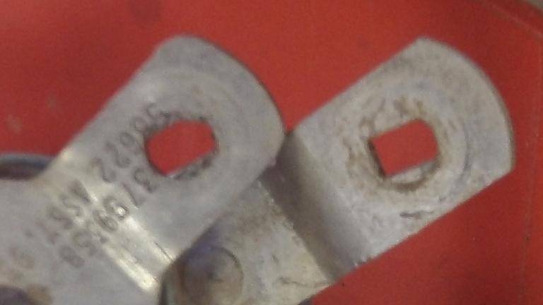

Those are expensive and notorious for self-destructing, even the "new" replacement pieces.
I'd replace the motor, arm and first linkage with the type that uses the small bushing. Probably not much of a price difference.

I think that's the 80's M body style?
Better design. Works the same with the modifications Jim is talking about and they don't explode like that older style.

They were one year only on the F bodies (78 I believe) and only a partial year and not all option levels. Not sure of M applications.
Never figured out what the hell Chrysler was thinking with that one.
The wiper motor shaft is a different profile but the standard style arm can be easily modified/filed to fit the shaft.

Well I got the replacement wiper link and installed it today. I thought I'd give a bit of feedback.
The new piece is made of a far better material than the original (which is good). The plastic is almost rubbery, you can squish it and it bounces back to its form.
The dimensions, however, were incorrect. On my Volare, the hole in the steel arm was smaller than the plastic piece. I had to remove some material (not too much) to make it fit.
It was a devil to get onto the arm, but I was successful and it gave me a chance to go through, clean and lube everything while I was at it.
The wipers work like new now...more "peppy" in movement, which I ascribe to the cleaning and lubrication.
I'm very happy.
1,492
Those “plastic” bushings, do take some effort and channellocks to popped into place.
It is not a "5 minute" job!
