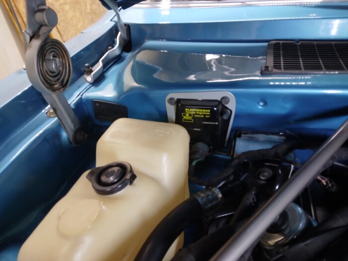

2,992
This is the regulator I went with. It's a made in USA repop. Only downside is they only come with the diagonal mounting holes, hence the adapter plate.
volare 1977
Jun 12, 2014
1,938
311
maryland
Yea, I forgot about that they changed the regulator mounting hole locations on the later years.
2,992
Reason the aftermarket ones have 3 holes. Main reason for the repop, other than thr made in USA part (and not China) is it "look right".
