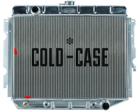

So...it's amazing what a pressure test of the system does. Come to find out my leak was actually at the bottom of the radiator and was shooting upward towards the underside of the pump/pulley. I bought this aluminum radiator about 2 1/2 years ago and I thought this company had decent quality. My question is what would cause this leak at the bottom? The rad is bolted down to the core support and I don't think it would be from vibration? Or is it simply cheap or poor quality?. Once the system was pressurized, I noticed a second new leak (not until this was done), about half way up on the driver side. I pressurized the system to about 15lbs. At this point, I thought of going with Griffin,Becool or Afco,but they're all around $800 and up. See the generic picture of the radiator and the spots of the leaks.

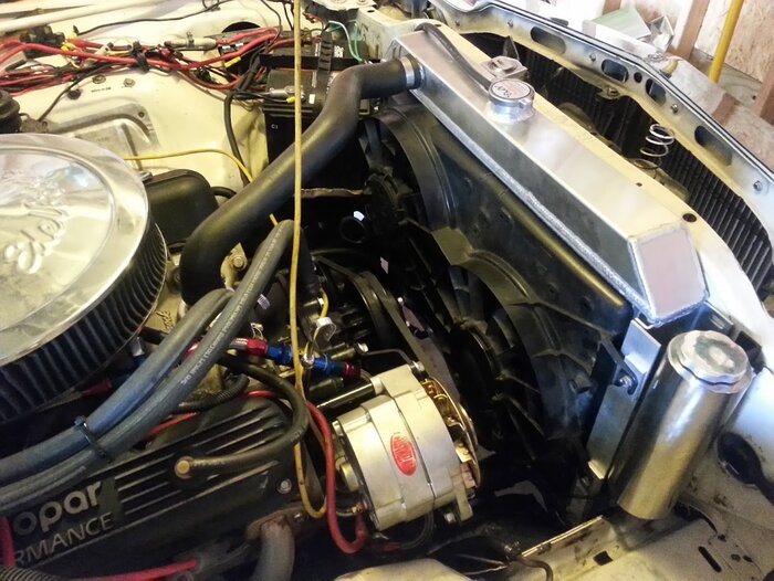

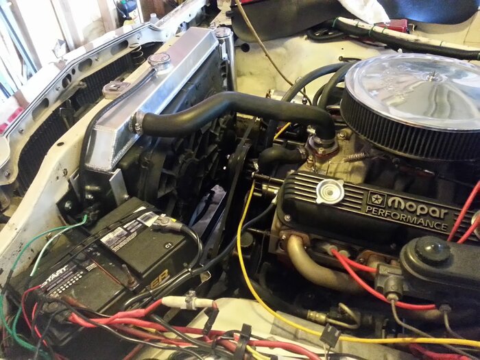

Here are a few shots of it installed when the car was still a small block. I did an electric fan conversion at the same time, but my Dad used this same radiator in his car and adapter a factory shroud. You'll also need a piece of aluminum or flat stock steel for the driver's side mount. If you can drill a couple holes this fits.

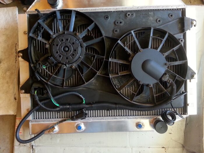

Which sort of electric fan are you running in the first picture? Is your radiator directly bolted to the support and should there be any concern for vibration?
I'm just curious why a 2 year old radiator would be leaking in those two spots in my picture and trying to figure that out.
1,830
1,035
I had the same reservations at first, but it's been directly mounted to the core support for the entire time it's been in the car. Never had an issue with the radiator.
Fans are from late 90's Ford Contour with a V6. Two-speed controlled by the Holley Sniper EFI unit. They fit the 26" radiator perfectly. Made mounts on the side from flat stock aluminum.
