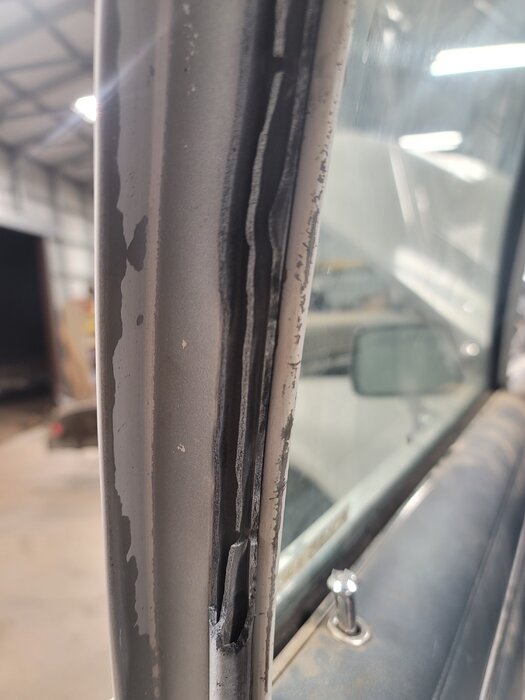

Through a lot of searching already, I'm understanding the weatherstripping, window seals, truck seals, etc are difficult or impossible to get for these cars.
Does anyone have any sources or solutions that haven't been updated in here in a while?
Save me from myself. I've got a can of Great Stuff and an itchy trigger finger. :)
Thanks!

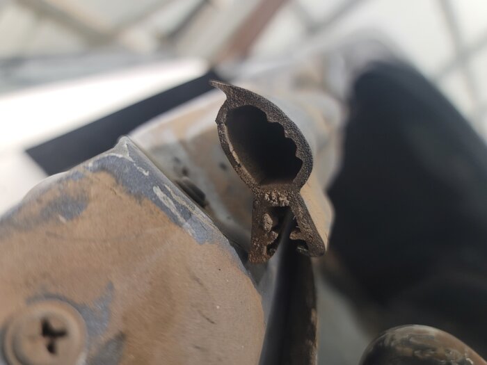

This or something similar is the trunk seal (I didn't bother trying to match it exactly).
Amazon product ASIN B00O8X8HGY

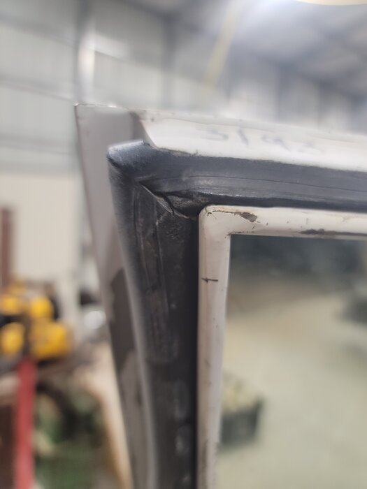

The door seal corner is one of the things I was talking about. You can get the right seal but then have to spend the time to add those sharp corners and the clips on the bottom to it.

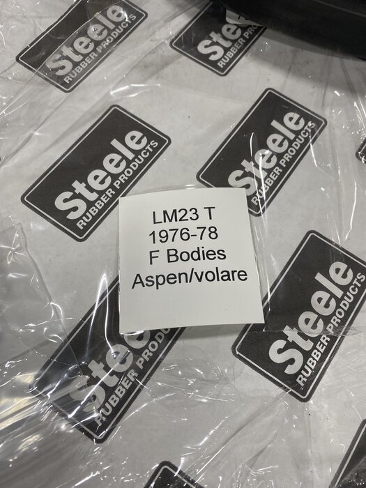

Aspen/Volare: Trunk, Door Seals and Roof Rail Seals (body side) are available for 76-78 2 door. Check with our suppliers here (JustMopar.com) the End Cap seals (by hinge pillar) I have not found. 79 Door Seals are molded with the End Caps, but the earlier 76-78 door seals will work.
Just got the Door Seals. They are made by Steele Rubber Products P/N LM23 T. Steele does not show this part number.
