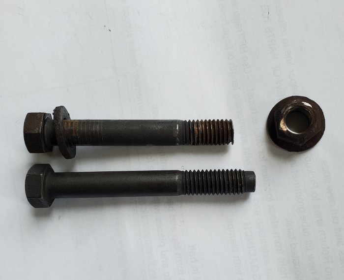

Good old sawzall did the trick.
Reggie
Apr 23, 2018
46
23
Maryland
Regarding the sawzall - I used a 6" carbide grit blade (an old one at that) and it cut through the bolt like butter.

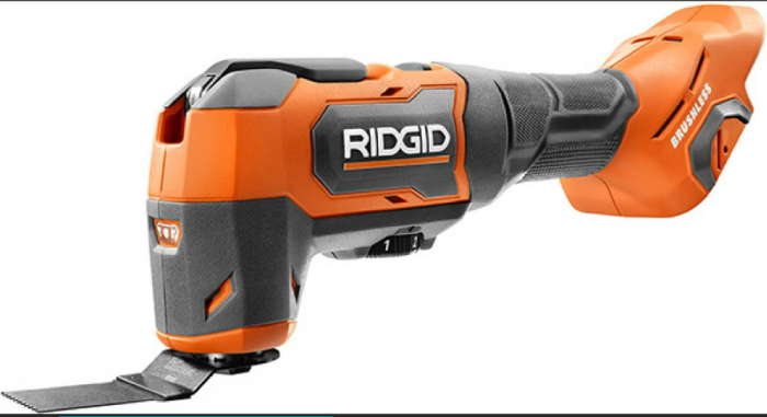

I stumbled into one of these tools when I needed to cut baseboards to clear new flooring without taking them all the way out. They run faster than sawzalls and you can push the blade directly into what you're cutting. I've even trimmed the sides of a blade to make a really, really narrow one. Really saved my butt on a seized control arm bolt that had no clearance for the sawzall blade to reciprocate.
7,323
2,971
That's one of those tools you didn't know you needed, until you buy one.
