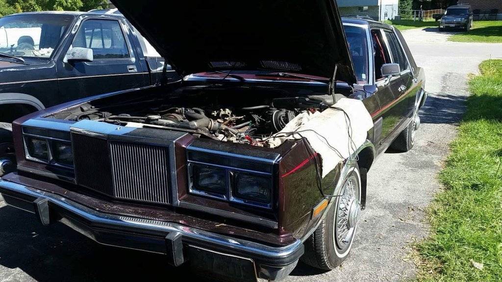

Today, I recurved my ProForm distributor because it had the advance coming in real early and the engine would ping if you had the initial set at anything more than 5* BTDC.
So I added a strong small spring and also added an FBO Systems mechanical limiter plate.
FBO Systems
I have my initial set to 15* BTDC, the limiter plate set on 18* of mechanical. This is a total of 33*, on top of that I have the vacuum can on a manifold vacuum pulling in 12-13* at idle and cruise. With that working, the engine idles at 28-29* BTDC. Off idle the mechanical comes in a little bit and the advance is theoretically at 45* while cruising around 1800rpm. This setup seems to work very very well, I was able to re-tune the idle circuits by richening them up some to get more idle vacuum/smoothness and also able to lower the idle stop screw making the idle circuits more effective.
Just curious as to others setups? I got it good and hot and let it sit and heatsoak to where the coolant had to be up around 220f in the engine. Guage showed half on the dash, fired right up just the same as when it was set to 5* yesterday. Technically, I could stand some more initial then couldn't i? lol

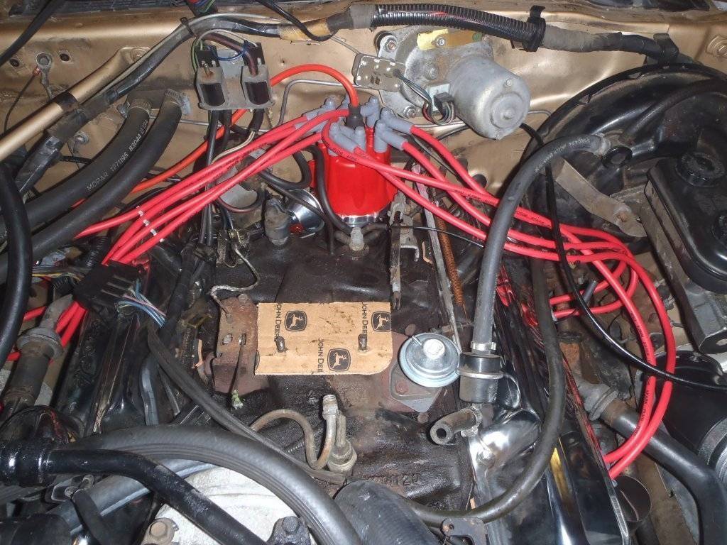

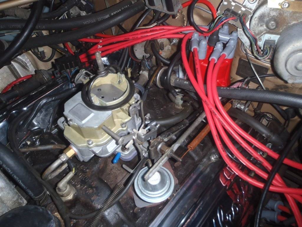

when I deleted my lean burn computer I went with an MSD ready-to-run dizzy. Set the timing to 16* initial as the sticker under the hood (I think) says. MSD sent lots of different springs and bushings with it, but since I wanted to get as much economy out of the motor as I could, I just left it as is. The factory curve gives a bit over 20* of advance. Don't get me wrong, it's still got plenty of grunt, but I can still pull 23-25 mpg on the highway.

His BBD carburetor appears to be a non-computer controlled one. Sense he has MSD ignition system – I would guess the Lean burn system has been de-activated.
If so, I would also guess his EGR is on there for looks, only (I seen the EGR control solenoids on firewall, still – but without a computer to operate them, they are there for the ride).
Nice looking cars rcmanic791 and 8v-of-fury!
yeah, most of the emissions stuff on there is just there; doesn't really do much, just keeps the man happy.
It's an '84 318. I just ran outside to check the tune-up sticker and it does say timing BTDC is 16*.
