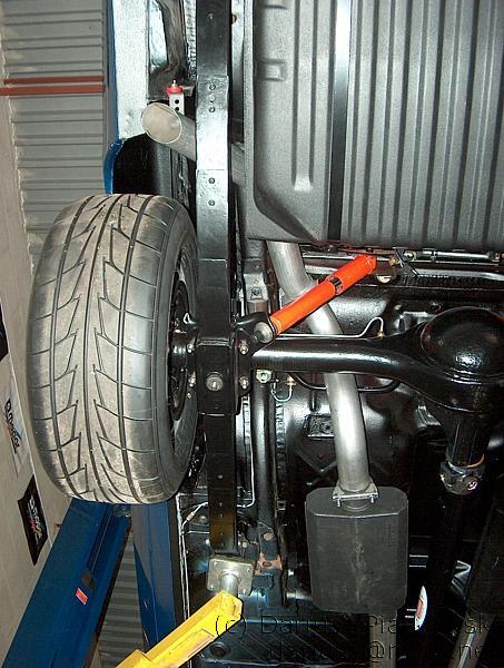

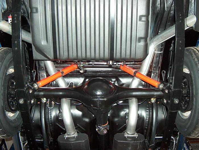

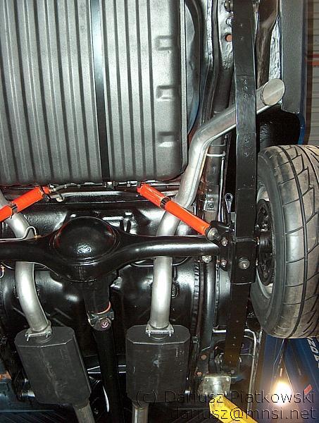

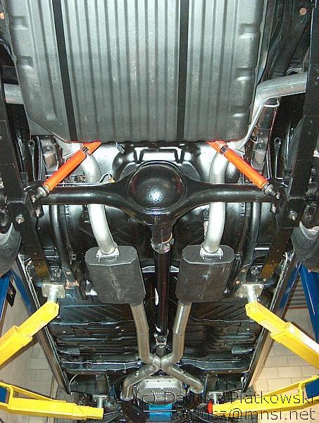

I'm running a 99 GT Stang exhaust.... yes, that's correct a ford exhaust. It was a "take-off" when the Stang's owner spent money on a custom exhaust. So it was a reasonable means to get my car through state inspection. I did not have to move the gas tank over at first, but it would have been easier. My tank is moved over now. The filler tube is cut and lengthen using a rubber filler tube from a late 90s Ram. The angle face at the tank and the filler cap are not easily adapted with a hard pipe extension. So my exhaust was a factory Stang H pipe with 3 cats per side. I cut the pipe in front of the last cat, so I'm legal with one cat per side. The post cat exhaust has the H and factory ford mufflers , over the axle too:

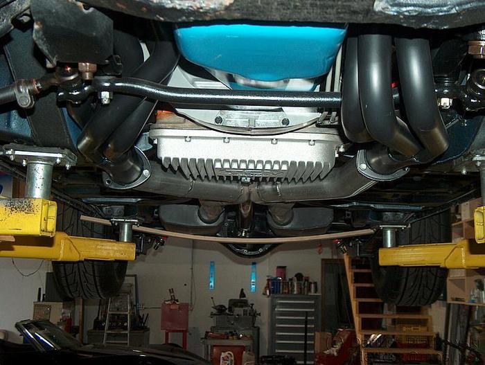

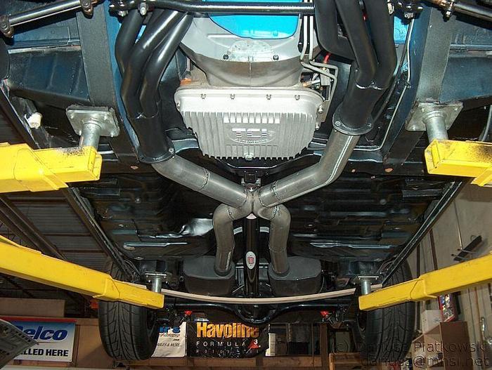

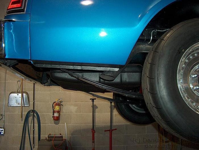

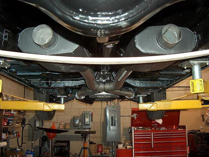

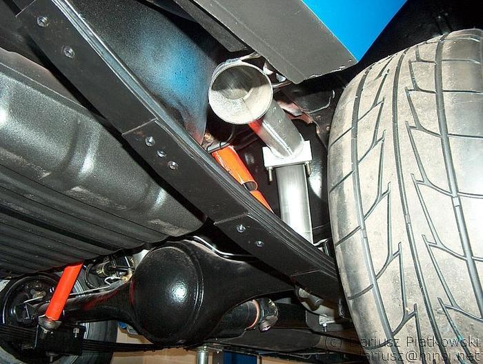

Alright, a tad late, but here it is: 3" pipe off of 1-5/8" primary pipe header, into X-pipe, into Hooker MaxFlows, over the axle, out behind the tire. Tank was not moved.
Here is the gallery:
What does all that get ya?
