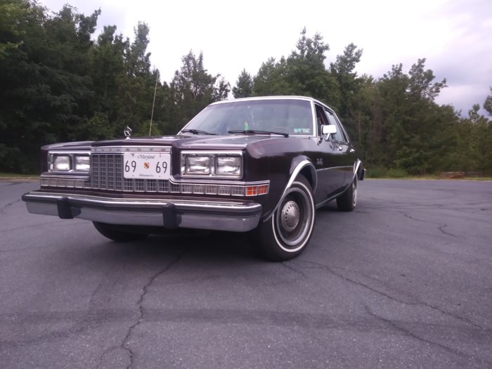

my father has owned 4 m's and i currently own an 88 Gran Fury. out of all M body cars i've come across all of them have dead horns! my car had a replacement horn from pep boys that the previous owner installed as two before died. it sounded awful but was very fun to toot.it worked for about a month until recently when it simply died. why do these cars kill their horns? is it the heat of the engines or a product of where they sit in the engine?

as you can tell by the plate I'm from Maryland where it gets very humid in the summer and it seldom snows but when it does it SNOWS. somehow this car has been spared the rust problems we get. the car has been beating directly on the car. the other Dips we had alternated between sitting in direct sunlight and sitting in front of the house in relative shade. Perhaps the horns are overheating somehow. the two horns are mounted right behind the grille. i think we have a few horns in the shed but they might be dead. i tooted the horn relatively often mostly to say goodbye to someone. i'm somewhat ok not having a horn as i only had to use it once to wake someone up who wasn't moving at a green light but its still a good thing to have just in case. by the way @AJ/ForumS it has a red interior.
