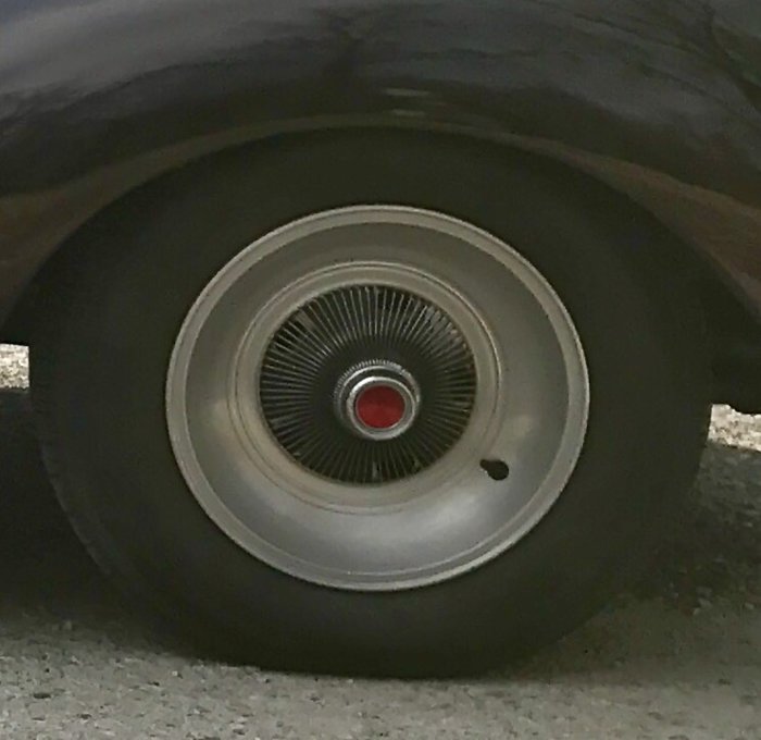

what value might wheels like these be if they are in good shape and complete?

From my research theses wheels are from a 1979 Chrysler Labaron or Cordoba only sold when new vehicle was purchased with the Alloy Wheel Option.
Not sure what I should attempt to sell for. My Dad had them in his garage for over 20 years.

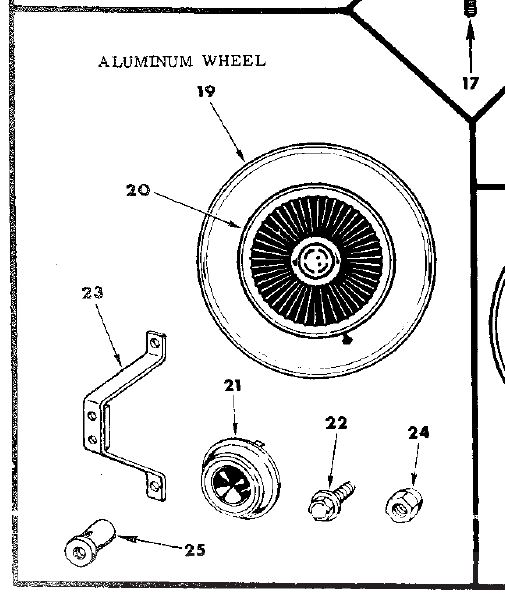

The problems that I recall were hard to get weights on. Generally had to use the stick-on ones on back side. Also, if the screw anchor (plastic) melted/got loose, which allowed the steel fins to eat large gaping and unsightly holes in the aluminum and make all kinds of noise, from being loose).

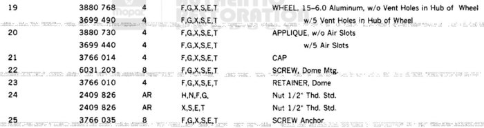

The red/chrome cap pops off. There are two small screws that hold the larger cap onto a C-shape bracket - under the red cap.

The plastic anchor can be fixed/replaced using Helicoil’s – providing the wheels are not damaged too badly.
If I had one of wheels, and the aluminum was in decent shape where the large cap contacted it, I might make something like a gasket (or something) to go between the two metal parts, after replacing the plastic anchors with Helicoil's - then you have an wheel without any more problems.
