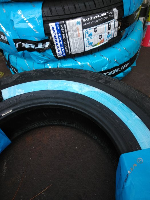

I found a source in Cali called Performance Plus Tire and Auto. They are located in Long Beach, CA and carry a new Chinese brand called Vitour Galaxy R1. They have 2 sizes for our cars: 215/75/15 with an 1 1/4" whitewall or 205/75/15 with an 1" whitewall. I bought the larger size for $89 each and they were delivered Friday. These are our only alternative if you don't have the money for Coker American Classics.

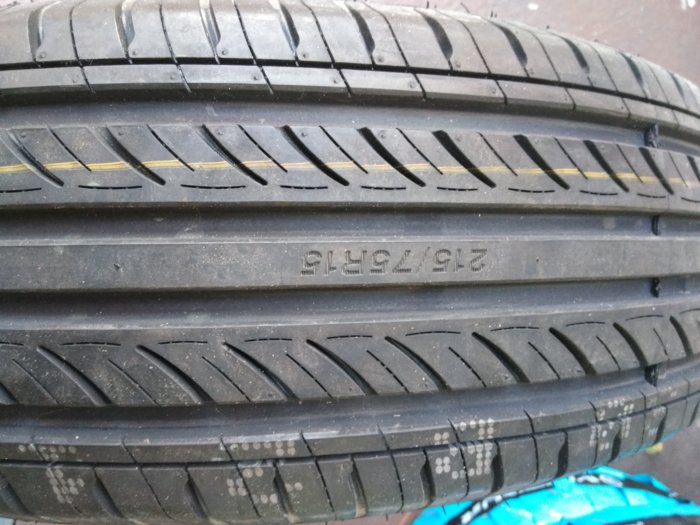

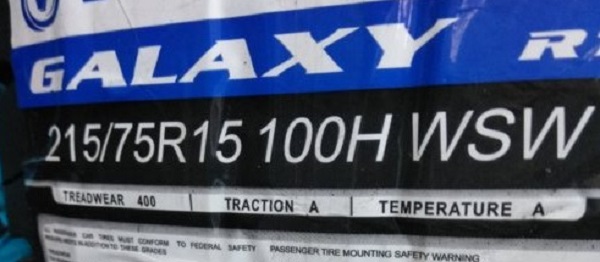

This tire (picture from above, cropped and rotated) has good numbers on it (Treadwear 400, Traction A and Temperature A). The Load range and Speed rating is 100H which is also pretty good. The speed rating of “H” is good to 130 MPH.
I see no problems using that tire (other than I prefer to use parts made closer to home).

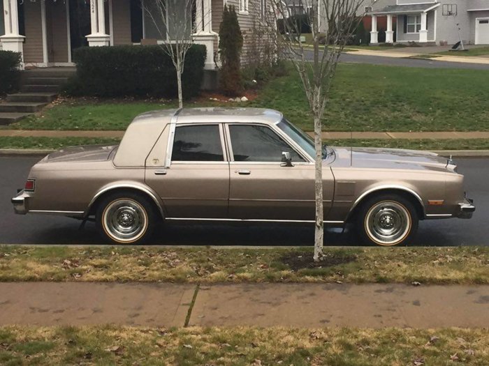

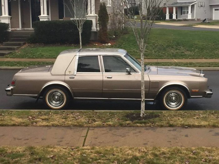

I slapped a set of 215/70/ R15 Vogues on my 89 5th Ave. I love the yellow stripe with the wide white...and the speedo reads correctly. Win-win.

With the color of you particular car, those tires are a perfect fit! Not sure how they would look on, say, a blue car for example.
