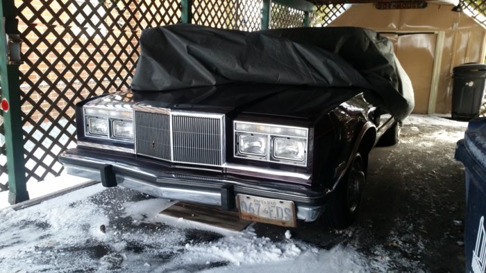

I have about the cheapest tires money could buy on the 5th, and they are fantastic.
They were Wal-Marts house brand WeatherMaxx All Season. It doesn't get driven in the winter, so it was a no brainer. They have plenty of contact patch which holds traction even when throwing this barge in to a corner. Obviously there is no worry about peeling off the rear ones.. not even in the rain.. lol
205/70/15 is what I got I believe.. $52 CDN? I think I paid.
ps. This picture was yesterday, has sat since middle of October. Did an oldstart/coldstart! lol, externally filled the bowls, hooked the battery up - first revolution of the starter she was purring away.

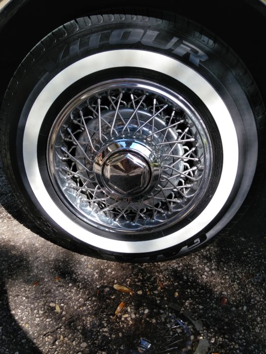

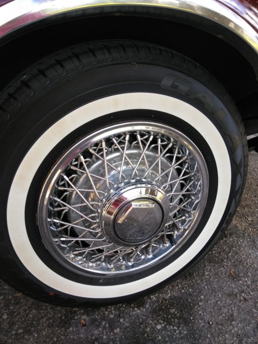

Sorry it took so long to update, but here are some photos of my Vitour Galaxy R1 225/75/15s installed. Very quiet tire so far. The only problenm I am having is the whitewalls keep browning! Wesleys BleachWhite every week seems to work, but the browning still reappears.
