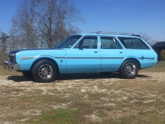

Wondering if 15x7 chrysler big bolt rally rims will fit a 1980 volare??? Would they be the same as the chryslre corporate steel rims???

Nice to know.Oh, almost forgot. The 15x7 wheels will fit just fine on an f-body.

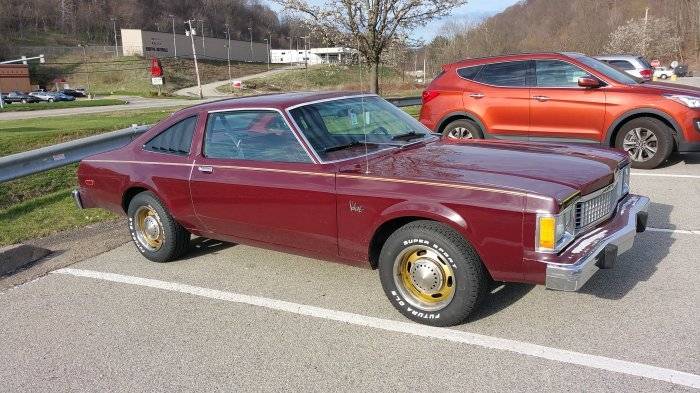

I agree that P235s are probably a lil tall. My old Volare did look a lil cartoonish.
P225/75 might be a good compromise. These are about 28.3 tall, and have a section width of 8.8 when mounted on a 6 inch rim; more when on a wider rim. I don't think the Volare will care about the bs, of a 6 or 7 inch wheel.
