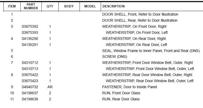

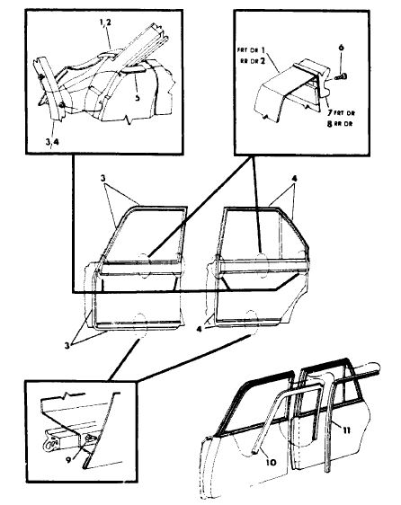

According to my ’87 (and ’84) FPM (Factory Parts Manual) – the inner window felts do not appear to be available separately from Chrysler (only come as a door panel assembly).
I’m fairly sure a person can get both inners and outers aftermarket . . . I would think.
Page pictures of the outer door glass seals/runs
A lot of these parts "appear" to still be available from Chrysler:
#7 4130712 FRT DR BELT OTR RT $21.25 (R/F Door Glass outer lower seal)
#7 4130713 FRT DR BELT OTR RT $21.25 (L/F)
#8 3875422 ASSY-RR DR WDO BELT RT $11.50 (R/R Door Glass outer lower seal)
#8 3875423 ASSY-RR DR WDO BELT LT $14.25 (L/R)
#10 4198637 FRT DR GLASS (front run channel) $114.00 (Left and Rights are the same)
#11 4198638 RR DR GLASS (rear run channel) - Superseded to 4198637 (cut to fit) Left and Rights are the same
