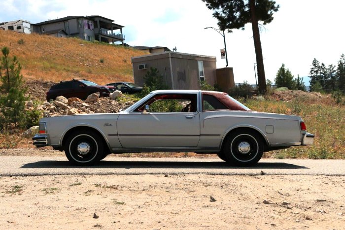

Are window regulators interchangeable front-to-front from the 4-door and 2-door M body If not where to get it or the parts? I have a Plymouth Caravelle coupe driver-door regulator that isn't working right. I think it's a roller or something don't feel like gears. Also, Here's a little something I found out when I got home from heart surgery. For some ungodly reason, someone tried to steal my rear shocks off my car. Also, Just a thought what other rear axle will fit the M body? thinking of going to a 360 with 727 short trans from the 318 /727 short trans.

Nope, 2dr and 4dr are different. 2dr F-body and 2dr M-body will interchange. Almost have to pull the door trim panel and see exactly what's broken first.
Are the windows electric or human powered?

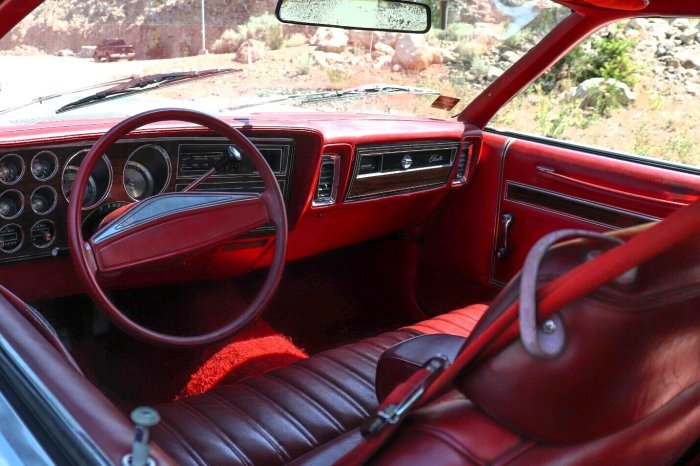

I thank you one and all for your help. I'm sorry about the description I gave I thought the photo might have helped.

It wasn't in the original post but it sure helps :)

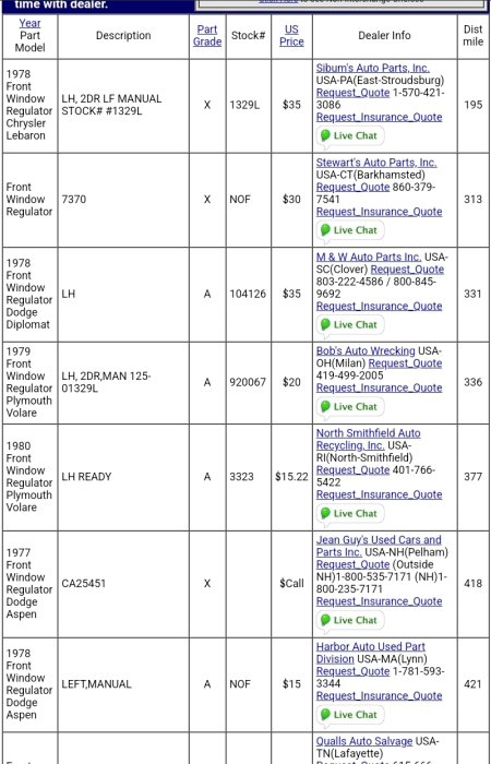

I have a NOS 77 drivers side volare regulator if still looking.
sweet that might be easier to find. shoot at step anymore I think I'd rather trade this thing for a 78 to 80 Volare as they both have a smooth ride. thanks for the info.
