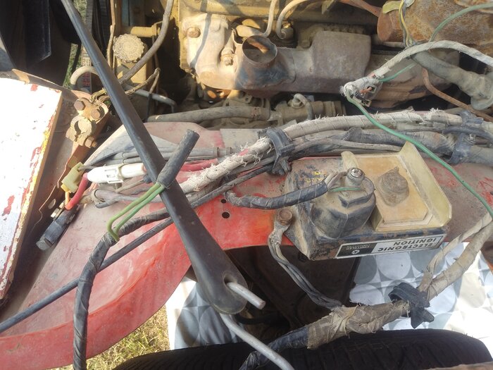

I have a question and I'm hoping someone can help. On my 76 Volare in the engine compartment in the main harness. I have 2 green wires that go into one pin, has power the moment the key's turned on. I have no idea what is sure to go there...can anyone help???

I will get a picture in the morning, I got thinking about that literally the moment I clicked post thread

Sorry for the delay, here is the wires I am asking about

Pigtail for fender mounted turn signals, should be one on the other side I believe tan in color

As said pigtail for the fender indicators. Can`t make out the other green wire by the ecu. Need a better pic.

That makes sense, I got the car and it was missing the drivers fender. And passenger side had already been changed so I had no idea what the original fenders looked like.
