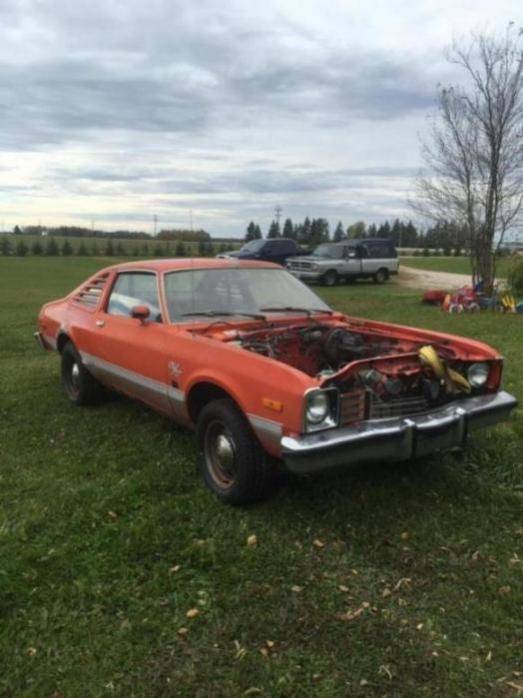

You can buy stainless steel swirl polished nail head valves that bump compression up. I've actually have a 360 that I'm building for my 79 Aspen RT. J heads, 2.02.
