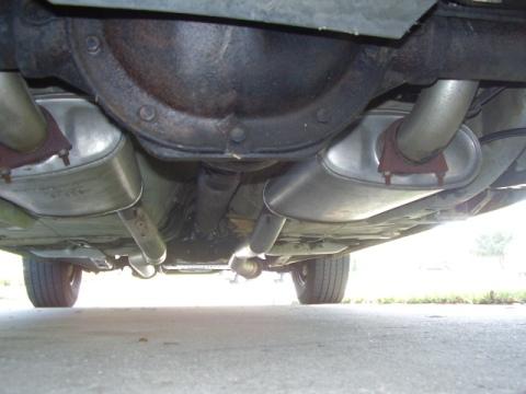

You might consider going dual exhaust now. Jeg's A body 2.5 inch fits nicely with just a bit of mods around driver's side but easily handled by a shop. Just need to do the gas tank shift and that's also easy. MANY have done it including myself and will guide you through it. Extend the filler tube with gas rated hose from any local parts store. I can give you measurements and pics and more info if you are interested. It intimidated before I did it and now I realize it's not a tough mod and well worth it!
Are you running headers or manifolds?
Were you able to go this route using the standard exhaust manifolds or did you switch to headers? I've got the Y-pipe issue on my 88 and narrowing our options down to going with this dual exhaust setup or sending my current Y-pipe to a muffler shop to craft a new one based on that.
