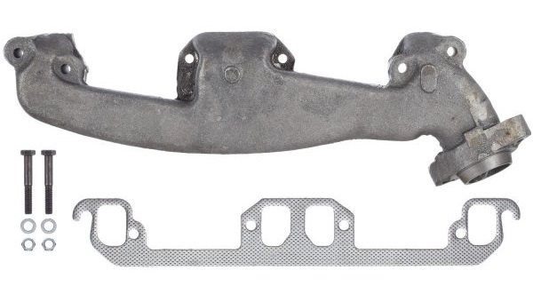

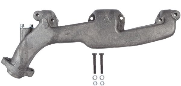

Magnum exhaust manifolds come in two different flavors (pickup, Dakota, Durango & B-van vs. Jeeps). For simplicity, I will use Dodge (pickup, Dakota, Durango & B-Vans – which are all the same) vs. Jeep (Grand Cherokee)
’94-03 Dodge versions:
Left (Cast # 53010187)
Right (Cast # 53010186)

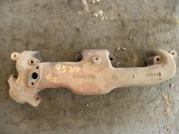

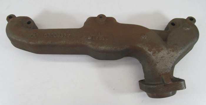

’93-98 Jeep versions
Left (’93-98 Cast # 53009377) - 2-1/8” inner diameter
Right (’93-95 Cast # 53009376).
Right (’96-98 Cast # is not known).
The Dodge version – the rear of exhaust manifold (either side) outlet will want to occupy the same space as your firewall - so modification of firewall will be needed (so not advisable).

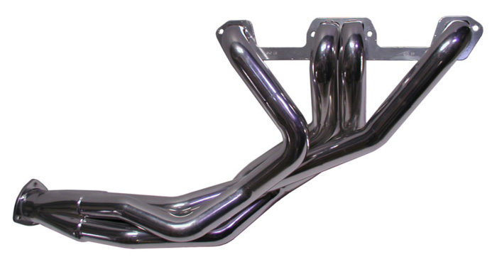

going to 360 in an 82 mirada -header space doesn't look good on pass side-whats everyone using-stock cast or? thanks
I used Sanderson "shorty" headers on my 360 Mirada. They worked fine.

I've used both of these:
1) 78050 HEADERS, Headman Headers
2) 5901 HEADERS, Hooker Competition headers
I like the Hooker brand better...just have a beefier feel to them, maybe even thicker tube wall?

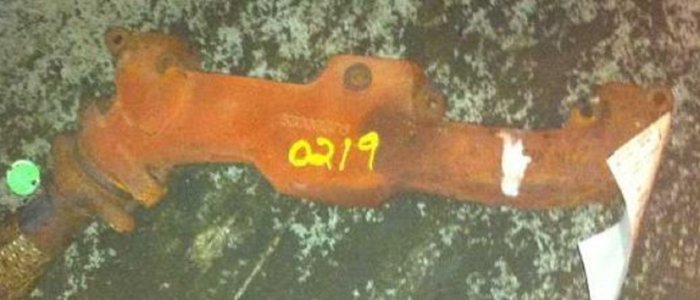

There are three different exhaust manifolds used for 318/360 Magnums in Grand Cherokees:
’93-98 Left Casting number 53009377 / Part number 53009379
’93-95 Right Casting number 53009376 / Part number 53009378
’96-98 Right Casting number not sure / Part number 53030869
The Part number is what you want if going to order one from Jeep. The Casting number is what everyone else uses.
The differences on the two right side exhaust manifolds is a pad an EGR valve tube attaches to. This pad can be blocked off using a piece of steel, a gasket and a few minutes to make a plate.
It is very possible that both Right manifolds use the same casting number – but only one is drilled for the EGR tube.
I hadn’t seen a ’96-98 manifold yet, to know.

You can see the picture of Right manifold of the hole that needs plugged – but it also looks like should be easy job on the bench.
I’m not sure why one manifold is $5 more expensive (and $6 higher freight) than other size is. I would bet a person would give a “best offer” for both and save 20-25$ (maybe).
