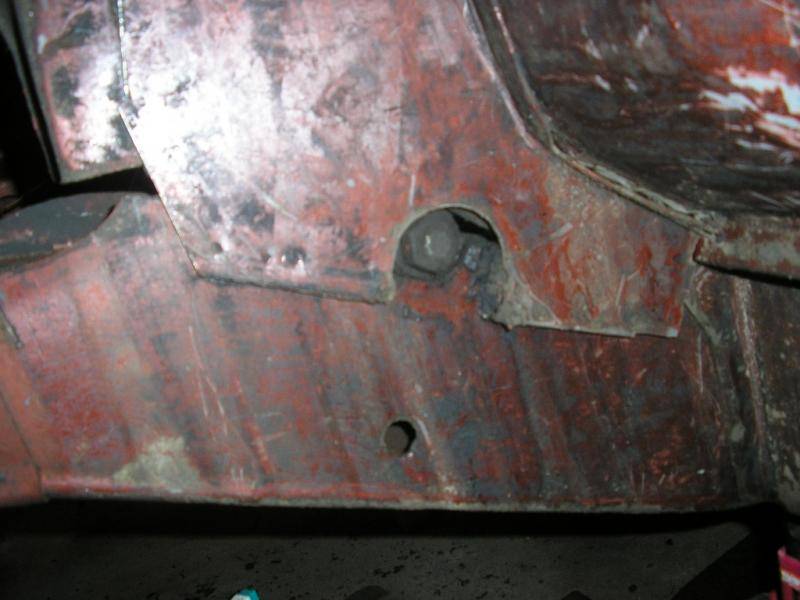

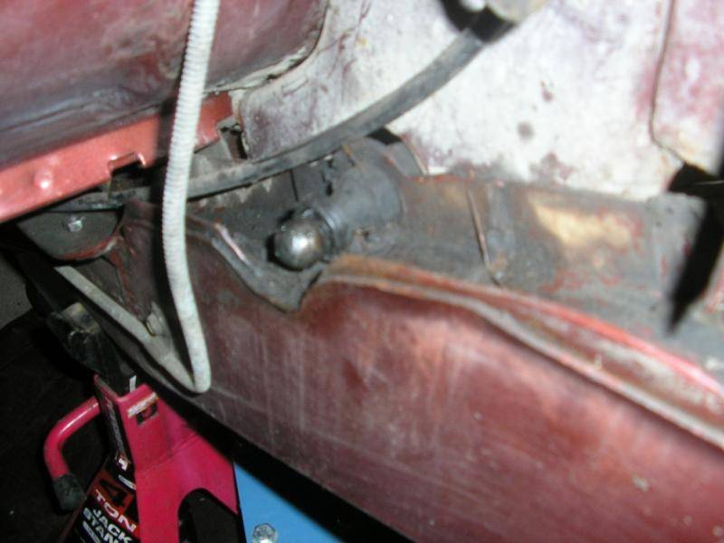

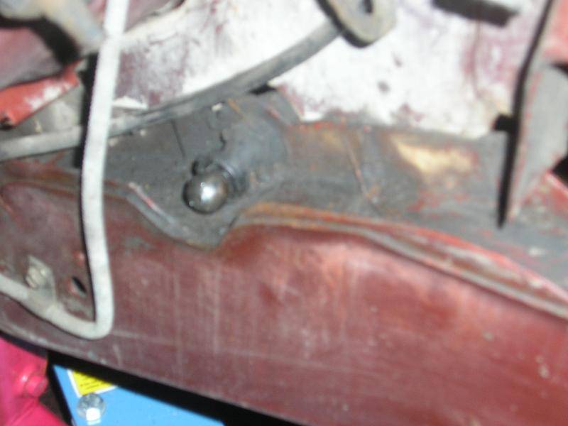

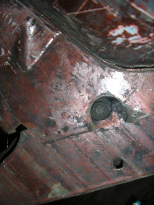

It helped alot! I looked at mine and the hole in the inner fender well is there
and the detent of the frame, so the factory already had it ready incase it
was ordered with a 4 speed. just need the pivot ball & bolt now.
Thanks for the pics.

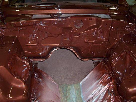

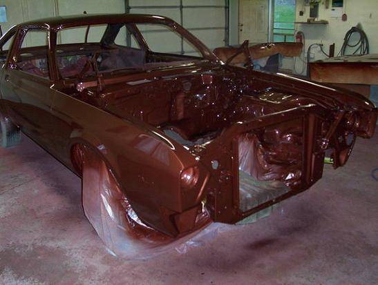

Almost ready for new paint. Don't go to all the work and not paint it. You will be sorry later on.
Yes for sure paint and detail EVERYTHING you can now no matter how tired and wore out you are. If you feel the urge to cut corners, shut the lights off and go in the house until you are back on track.
-Kenny
For sure. Fine advice 76 and Brem.

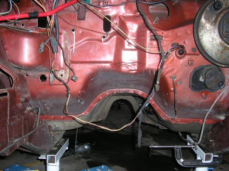

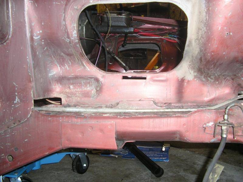

I probably have half the undercoat on the car off. I have yet to attack the rear of the car yet.
The underside (out of sight) I can do and plan on using Rust Bullet and their black Shell. I want to paint the engine compartment and wheel wells. Have no idea how to start, what to use and have no tools for painting. Do I do a factory finish for the engine compartment or a more glossy look? What are the pluses and minuses to those two looks/finishes? The wheel wells and facing frame rails will need painting. Then undercoat it??? I just scrapped the old shit off.
Auto painting is a skill I have not developed.
I'll leave the outside body to a pro.
